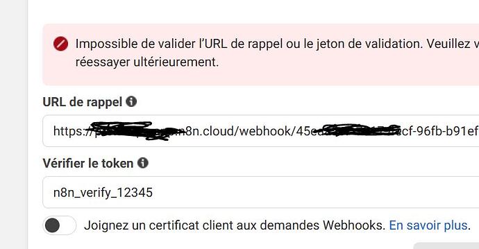

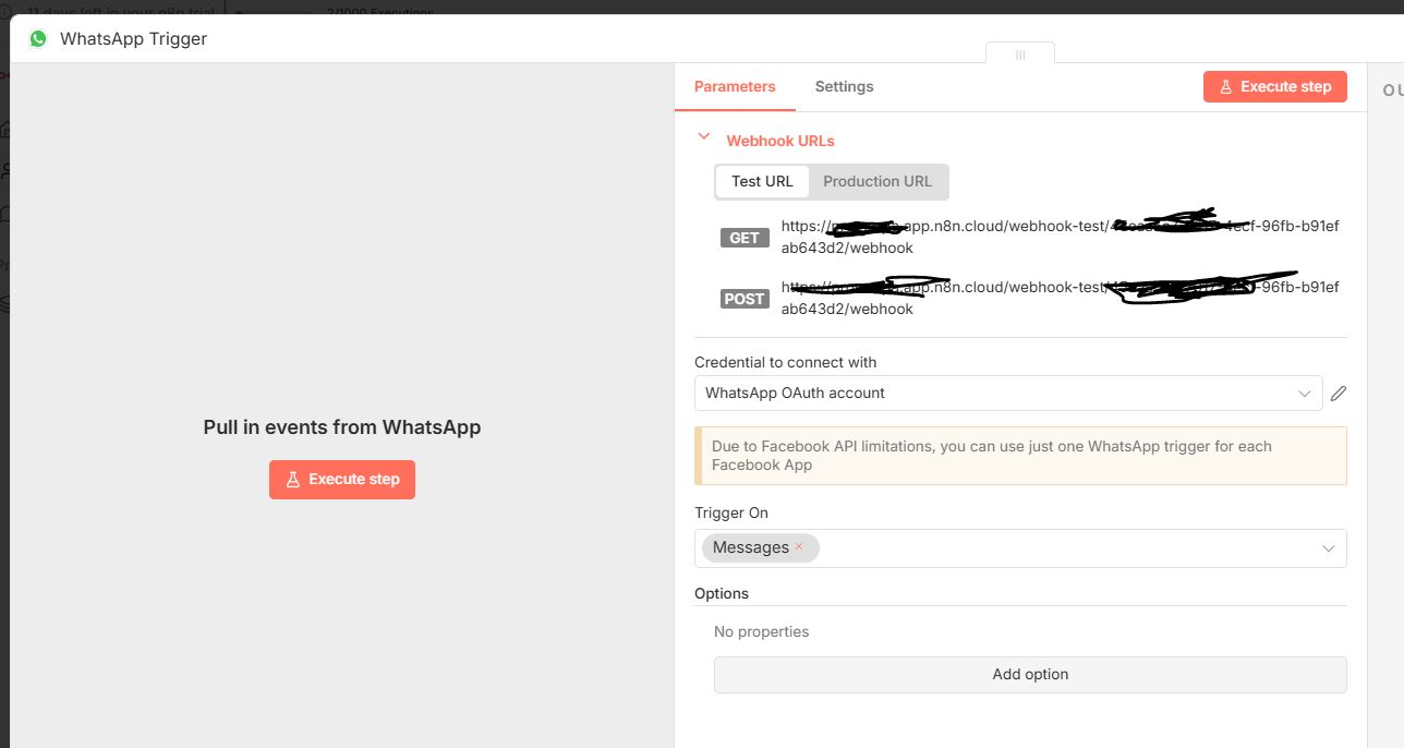

Hi,
Thanks for your detailed answer.
Step 1: Get Your n8n Webhook URL
Do i use test or prod ? and get or post ?
Step 2: Configure Webhook in Meta Business Suite
In WhatsApp > Configuration
Unable to validate the callback URL or the verification token. Please check the information provided or try again later.

Step 1: Test vs Prod & GET vs POST
Production URL - Always use the production webhook URL (not test).
The WhatsApp Trigger node in n8n shows you the webhook URL - copy it exactly as shown. You don’t choose GET/POST - Meta uses GET for verification and POST for actual messages automatically.
Step 2: “Unable to validate callback URL”
This error happens during Meta’s verification process. The fix:
Critical: Your workflow MUST be ACTIVE during verification!
  1. In n8n, activate your workflow (toggle to green/active state)
  2. Then go to Meta and try adding the webhook URL
  3. When Meta tries to verify, it sends a GET request to test the connection
  4. If your workflow isn’t active, n8n returns 404 and Meta shows that error

Step 3: No “Webhook Settings (Advanced)”
This is version-specific! Looking at your screenshots, you’re using the WhatsApp Business Cloud Trigger node.
For the WhatsApp Business Cloud node, the verify token is handled differently:
  1. In your WhatsApp node, look for a field called “Verify Token” or “Webhook Verify Token” in the main parameters (not advanced)
  2. If you don’t see it, you might need to update your n8n version - verify token support was added in recent versions
  3. Alternative: Use the “WhatsApp Trigger” node (not “WhatsApp Business Cloud Trigger”) - it has better webhook verification support

Your Screenshots
I can see you uploaded 2 screenshots - they’ll help me give more specific advice. Looking at typical issues:
Screenshot 1 (n8n_Capture1): Should show your WhatsApp trigger node
Screenshot 2 (n8n_Capture2): Likely shows the Meta webhook configuration
Can you share:
  1. What n8n version you’re using? (Settings > About)
  2. Are you on n8n Cloud or self-hosted?
  3. When you activate the workflow and copy the webhook URL, does the URL start with https://?
