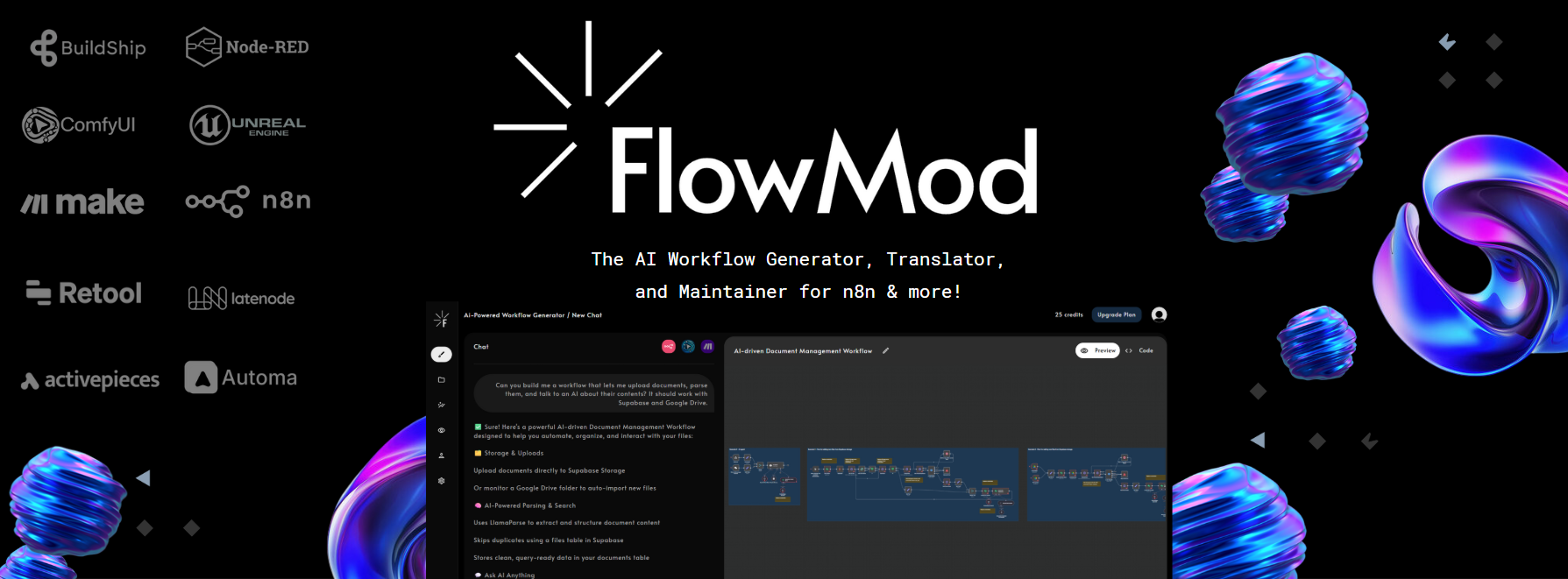

Did you use FlowMod ? I have tried a couple of similar n8n chrome extensions with big words about AI on their landing pages, and they simply did not work adequately on real-world n8n scenarios - I think n8n is just not a good fit for serious API/MCP-powered workflow creation
I have not yet, joined the waiting list to get access to try it out, but it looks promising compared to the others. Yeah there are a number tools and workflow agents built to try and generate n8n workflows. You still have to tweak and fix some of them. I still prefer to build my workflows by hand as I think its quicker than to prompt a 100 fixes for gen ai ones :slightly_smiling_face:
