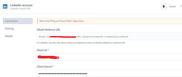

I’m self-hosted so my url is localhost****** , and I followed the instructions on the n8n documentation for self-hosted
But when i’m trying to set the LinkedIn connection it provides a callback url that is on n8n cloud, i think that’s the problem, so how can i connect to LinkedIn when I’m using self-hosted n8n?
Docker self hosted? You may have to change your env variables to have it update the URL correctly.
You will have to update these:
environment:
- N8N_EDITOR_BASE_URL=http://127.0.0.1:port
- N8N_HOST=127.0.0.1:port
But I am unsure if n8n will function correctly with a fully localhost IP.
URL mismatch between redirect URI and the one set in the connection will always cause issues.
i did a workaround using ngrok and assigning a webhook and worked
