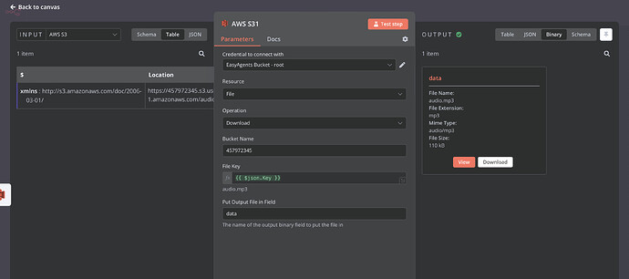

@barn4k Thank you! That worked, follow up question with the output. The Location seems to be an XML file, but what I wanted was just a link to be able to hear the sound. What would a work around be?
Its should not be an xml, its a file “data” without the extenstion. You need to save the proper filename in the filename field instead of “data”

I tried that, but when I open the link (https://457972345.s3.us-east-1.amazonaws.com/audio.mp3) I get a access denied:
You will need to modify the bucket ACL or be logged in to the AWS to download it.
Or you can use the S3 Node with Download file action in n8n.
What would I put for the S3 Endpoint? @barn4k
This doesn’t give me what I want though. I literally just need a media url that is shareable. The actual link to the media. It seems like the download file feature just gives you the mp3 binary data. Which brings me back to square one, since the whole point is that I already have the mp3 binary data and need to get the sharable media url.
