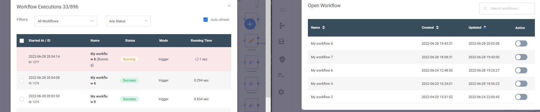

Why do some workflows run even when they are inactive?
After turning off the workflows, they are still being executed.
I had originally suspected it is an issue of kafkajs but it doesnt seem so as they can be seen in the execution history.
The workflow
It consists of just one kafka trigger and a kafka node which sends out messages during off hour
  • n8n version: 173

@Jon I havent been able to find anything useful from the debug logs, everything seems normal.
I have always disabled the workflow from the UI, suspecting if it has something to do with database connection.
In some cases if I turn off Workflow 1 and Workflow 3 which have the same kafka topic as Workflow 2, I receive 3 responses from all of them.
Running into this issue again when two instance shares the same DB with different encryptionkey. Could this be that cause ?
Not only did an inactive flow run, there were cases where a deleted flow remains running until a restart.

Jun 15 06:54:52 workflow-dev docker[901732]: 2022-06-15T06:54:52.845Z | verbose  | Successfully deactivated workflow "13" {"workflowId":"13","file":"ActiveWorkflowRunner.js","function":"remove"}
Jun 15 06:55:05 workflow-dev docker[901732]: 2022-06-15T06:55:05.716Z | debug    | Received trigger for workflow "Jennifer's (Authorised)" {"file":"ActiveWorkflowRunner.js","function":"returnFunctions.emi>
Jun 15 06:55:07 workflow-dev docker[901732]: 2022-06-15T06:55:07.370Z | debug    | Received child process message of type start for execution ID 3051. {"executionId":"3051","file":"WorkflowRunner.js"}
Jun 15 06:55:07 workflow-dev docker[901732]: 2022-06-15T06:55:07.382Z | verbose  | Initializing n8n sub-process {"pid":1306,"workflowId":13,"file":"WorkflowRunnerProcess.js","function":"runWorkflow"}
Jun 15 06:55:07 workflow-dev docker[901732]: 2022-06-15T06:55:07.683Z | verbose  | Workflow execution started {"workflowId":13,"file":"WorkflowExecute.js","function":"processRunExecutionData"}
Jun 15 06:55:07 workflow-dev docker[901732]: 2022-06-15T06:55:07.687Z | debug    | Received child process message of type processHook for execution ID 3051. {"executionId":"3051","file":"WorkflowRunner.js>
Jun 15 06:55:07 workflow-dev docker[901732]: 2022-06-15T06:55:07.688Z | debug    | Executing hook (hookFunctionsPush) {"executionId":"3051","workflowId":13,"file":"WorkflowExecuteAdditionalData.js","funct>
Jun 15 06:55:07 workflow-dev docker[901732]: 2022-06-15T06:55:07.688Z | debug    | Start processing node "Web Widget Trigger" {"node":"Web Widget Trigger","workflowId":13,"file":"WorkflowExecute.js"}
Jun 15 06:55:07 workflow-dev docker[901732]: 2022-06-15T06:55:07.689Z | debug    | Received child process message of type processHook for execution ID 3051. {"executionId":"3051","file":"WorkflowRunner.js>
This is my logs after deactivating a workflow, it still runs anyway
