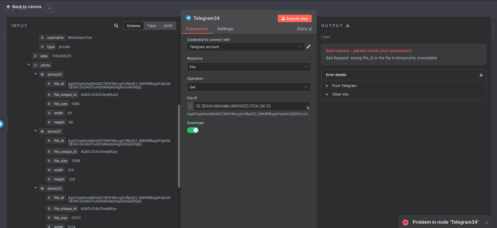

Why I can’t get photos from telegram? It says file unavailable. I upload only one file.
Apparently this problem is related to the n8n update? It works fine on the other version.
I tested on my end and it’s working normally.
Perhaps add a wait node between these two for 3-5 seconds
Guess there is a potential delay when upload the image and get from webhook at the same time.
on the Receive node you can also use the option to immidiately download files
