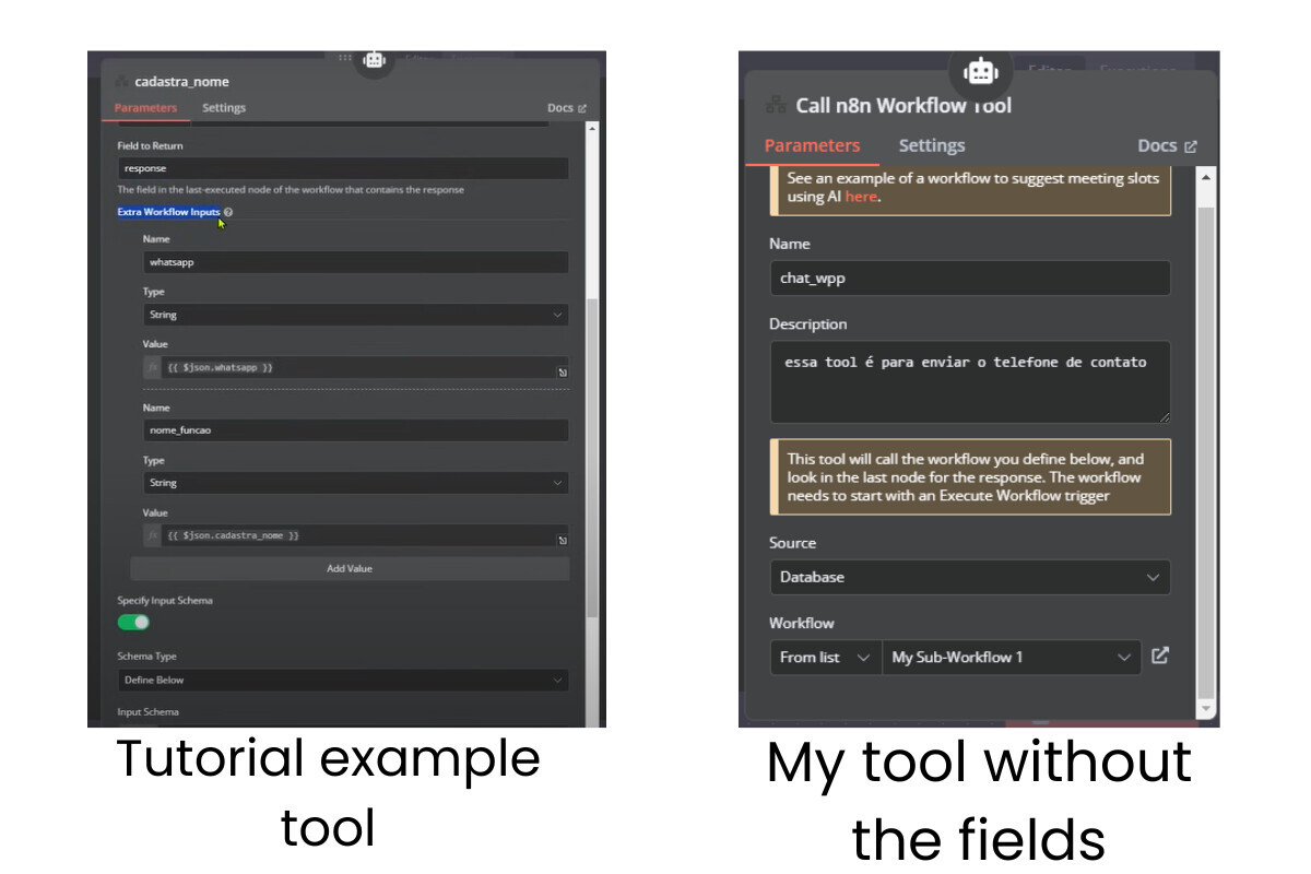

Liam they apparently closed the problem, I really don’t understand why they changed this, now they said that all the information can be passed to the sub-node to “make it easier”, but for example we had the “extra workflow inputs” fields that were removed, in them I generally passed external information that was received via webhook, in an assertive way, so now I will be forced to pass this information to the agent for him to pass on, it doesn’t make sense, it only increases unnecessary processing of information in the agent and increases the possibilities of causing problems when it passes the parameters… I really can’t understand the rationality in taking away functionalities that give freedom to the user…

I’m looking for a solution to the problem, and I see the image I made and posted in the community circulating in other forums hahahahahaha. Yeah, the problem seems serious indeed. I don’t know if I should ‘downgrade’ my N8N or adapt to the new scenario. The tricky part is that every tutorial includes this extra fields thing. I guess we’ll have to adapt to the new scenario after all.

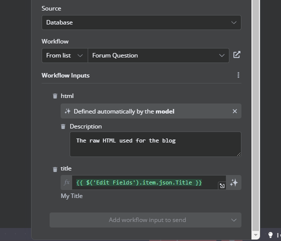

let me try to help with some of the confusion: We changed how the sub-workflow tool works in n8n a bit: Instead of defining a schema in the tool call, you can now define the data you expect directly in the sub-workflow: Think of it like a function in code where you define arguments.
This allows you to have a tighter fit between agent and the workflow tool and a better overview over what you need to input here.
Generally, you want to define the expected inputs in the sub-workflow trigger, like below, with whatever data the Agent (or you) should provide
When calling the tool, you can then decide if the values should be provided by the Agent or if you want to pass “hard-data” into the tool
Please let me know if think that does not make sense for any of your use cases.
