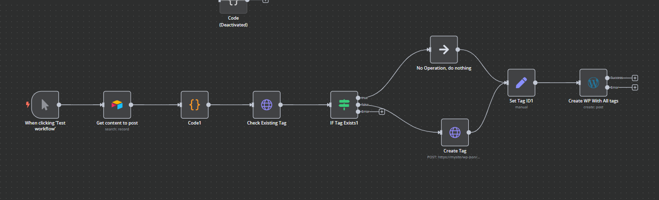

Hey folks looking for some help with wordpress tags ids. I am getting new Tag Names from Airtable> and creating the WP IDs for these if they dont exist. Now for the life of me I can not get the create WP Post to ADD all the new tag IDs to a single post. the Wordpress create post is creating multiple posts each with 1 of the tag ids! Ive spent a very long time and tried everything I can think of - can anyone help thanks
What am i missing? AI overlords have not helped
Wordpress is creating Multiple posts - 1 post for each TAG ID but i need 1 WP Post with aLL the tag ids added. Tried execute once but then i just get 1 tag created

Hi @aidiva
I think what is happening is your workflow is passing multiple items down the workflow and therefore will create one post for each item in the workflow.
You could try and add a code node after your set items node to bring all of the tag ID’s together and then use that as an expression in the post to WP node.

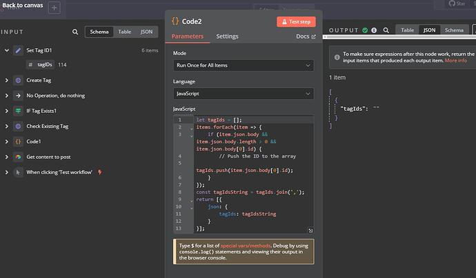

Here’s an example of the function to use in the code node:
let tagIds = [];
items.forEach(item => {
    if (item.json.body && item.json.body.length > 0 && item.json.body[0].id) {
        // Push the ID to the array
        tagIds.push(item.json.body[0].id);
const tagIdsString = tagIds.join(',');
return [{
    json: {
        tagIds: tagIdsString
This should return:
"tagIds":
"19,20,21"
and use the expression in the post to WP node.

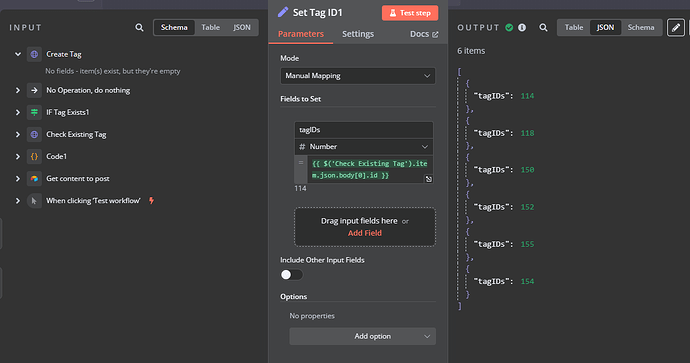

Hey thanks for replying. I actually used an aggregate node after the Set after posting as realised the issue is this
Set TAGID = a list of tags and Wordpress wants and Array of TAGIDs
But still cant get the correct array output for the tagIDs grrr!
Tried your code but it doesnt output the tag ids as an array sadly -
See the set tag IDs - its correctly picking up ALL the tag IDs but i then need to convert this to an array and cant work out how to correctly do that
Thanks
hey finally have it working after WAY too long - thanks for pointing me in the right direction. I actually got it working with an Aggregate array in the end woo hoo!
