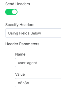

I can’t think of anything you can do with the Wordpress node, but you could use a standard HTTP Request node and set a different user-agent using the headers there. You’d need to know the API call URLs for wordpress rather than relying on the node to know them for you, but should be able to use the existing credential.
