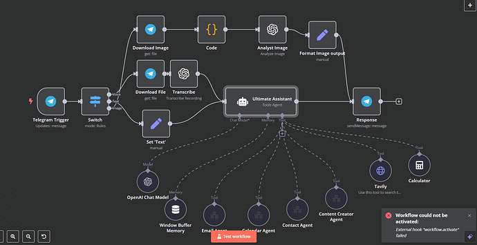

"Workflow could not be activated. External hook 'workflow.activate' failed."

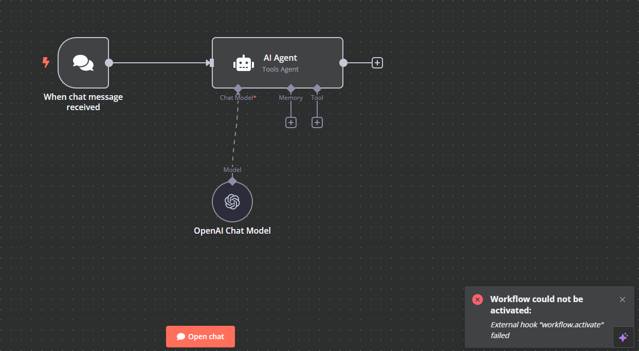

I’ve created a few workflows, and they’ve been working perfectly during testing. However, I’m running into an issue when trying to activate them I have several workflow but only two of them activated others will not activate even I created very simple one still problem exist. —I keep getting this error message:
“Workflow could not be activated. External hook ‘workflow.activate’ failed.”
  • n8n version 1.79.3:
  • Running n8n via (n8n cloud, ):
Are you using n8n Cloud?
  • n8n version 1.79.3: 1.79.3
  • Running n8n via (n8n cloud, ): cloud
n8n Cloud Free Plan allows only 2 active workflows at a time.
Solution:
Upgrade your plan or deactivate one of the active workflows before enabling a new one.
I have upgraded already and paid for entire year!
Sometimes, n8n cloud does not properly release inactive workflows when upgrading. Try:
  • Go to the “Workflows” page in n8n Cloud.
  • Manually deactivate ALL workflows (including the two that are active).
  • Try activating the problematic workflow again.
  • If successful, re-activate the previous workflows one by one.
yes, you are correct I did deactivate one and other worked but why after upgrading still is the same? I’d really appreciate any advice or feedback—thanks so much in advance! :pray:
Try logging out and back in, then refreshing your browser cache (Ctrl + Shift + R on Windows/Linux, Cmd + Shift + R on Mac).
Yes, I did try just now logged out and logged in and refresh the browser but still same. I’m going to try with different browser now and see.
All fixed!! :slight_smile: Thank you so much Johnathan!!
