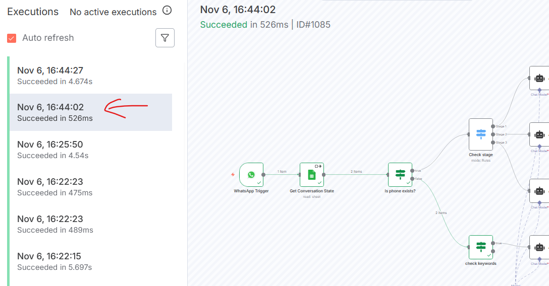

Workflow executes 1 time but run 2 times concurrently. Please help!
Execution log shows 1 time (which is what I want) but the workflows run 2 times concurrently.

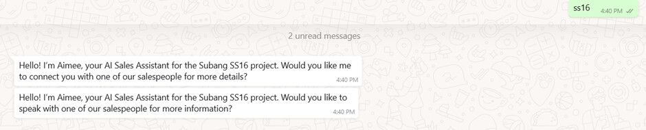

Result: It sent 2 duplicate messages

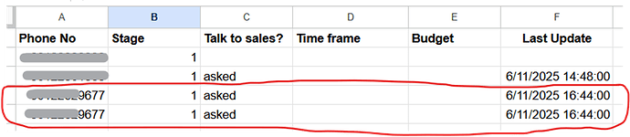

And save 2 duplicate records with same timestamp

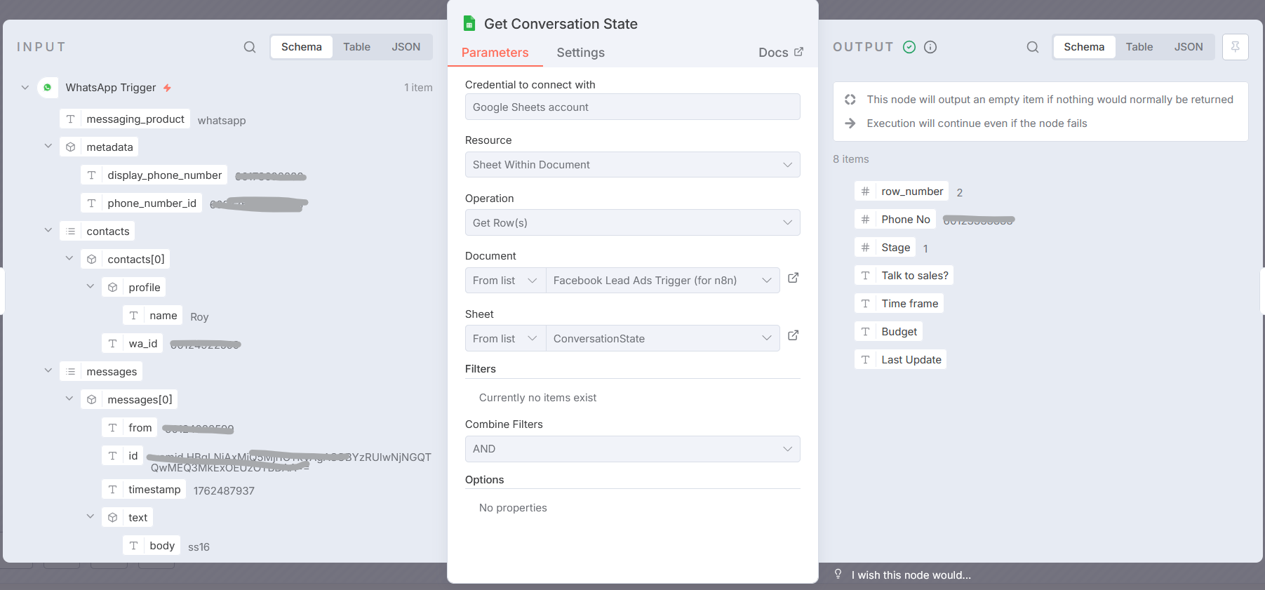

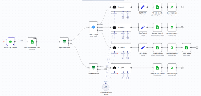

The messages are exactly the same, meaning that what executed twice wasn’t the AI Agent, but the WhatsApp node. n8n nodes on default execute once for each item. If your WhatsApp node is receiving two items, it’s normal for it to execute twice.
Go to node settings and toggle on Execute Once option for WhatsApp node.
If this doesn’t solve your issue, could you show us an execution where the WhatsApp node was successful?
But it still save 2 times on google sheets
I just identified the problem. I didn’t set any filter for Get Rows operation from google sheets.
