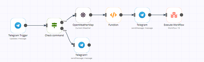

So, here’s my original workflow:
As you can see, the Execute Workflow has been added correctly.
