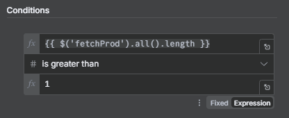

Hi @Bogdan_M
I think this is the problem, your condition is clear:
Whenever the fetchProd node output items are greater than 1, the loop continues, which causes the infinite loop..
I tried it with mock data, and this is exactly how your logic behaves..
You could probably try using the Loop Over Items (Split in Batches) node instead..

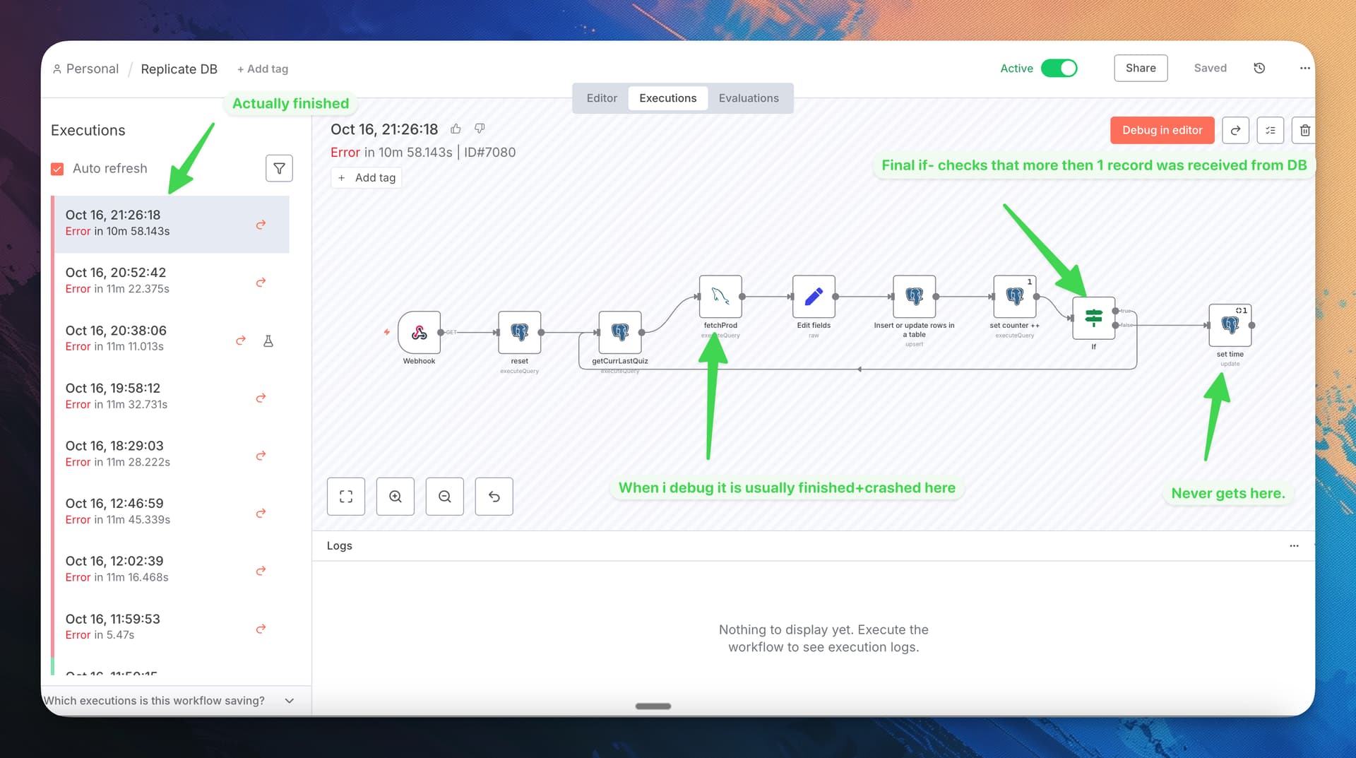

The looping issue is now fully resolved — the workflow correctly exits the cycle once all records are processed.
However, there’s still one persistent problem: when running the full dataset (~50,000 records), the workflow eventually crashes on the MySQL node near the end of execution.
What’s strange is that:
  • All records do get written successfully before it crashes.
  • The same exact logic runs fine with smaller subsets (e.g. 20,000 rows).
  • There are no visible errors in the n8n logs or console — it just dies silently while the MySQL node shows as “running.”
So it seems like some kind of resource exhaustion or timeout happening only under higher load, even though the query itself is valid.
Have you seen similar behavior with large data writes or long-running workflows where a database node crashes silently despite successful execution?
probably..
if this works, then use the split in batch loop with Batch Size 20k, or even better approach to use a subworkflow..
What my batches are 5000 at a time. Or do you mean something different?
