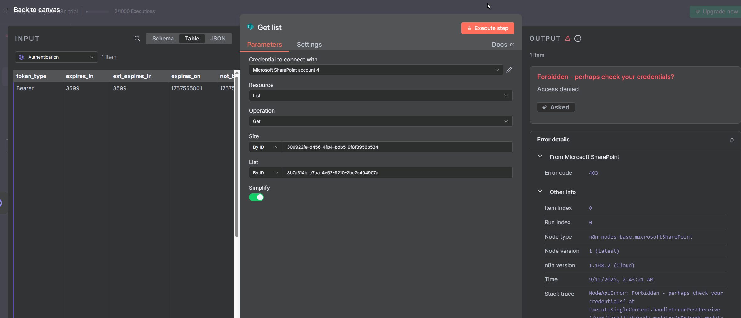

But if the Sharepoint-node is connected, I cannot choose from a list inside Sharepoint, and the entire workflow fails!

I cannot use the Sharepoint node, because there is a mismatch between my registered Entra-app (with the necessary rights) and the subdomain.
The app is created via thesafezone.eu. However, the Sharepoint is on thesafezonevr.eu (as thesafezone was alreade taken).
Leading to “The client has requested access to a resource which is not listed in the requested permissions in the client’s application registration.”

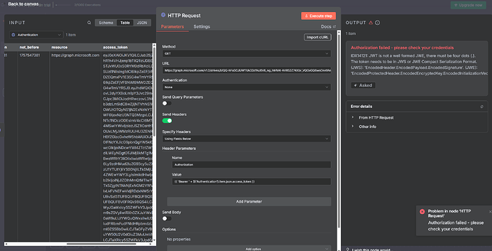

Via HTTP-node: can you please tell me what I am missing now?
(Note: The secret is not correct - but during the trial it was, and I got a bearer token).
However the last step bings an error:

Forbidden means the app is missing some permissions.
As for the HTTP node:
Check the url, it either should be _api/web or _api/lists, not _api/web/lists
Get to know the SharePoint REST service | Microsoft Learn
Plus check the method, POST is for creating a list, but you didn’t provide any body for it

If I connect the HTTP-Request - I get “forbidden - 403”. Even though the permissions are Files.Read.All and Sites.Read.All . Even though it comes directly from Authentification. But: the workflow and the authentification only works if the HTTP-Request is not connected…
At various times I also got “malformed header” - even though the Bearer-token came directly from Authentification…
If I connect the Sharepoint-node - I get “Access denied - check your credentials”. The Connection is valid, the permissions are Files.Read.All and Sites.Read.All

malformed header:

the sharepoint node uses only these scopes:
`openid offline_access https://{{$self.subdomain}}.sharepoint.com/.default`
As for the HTTP node, you didn’t set the Expression mode. Try this node
Thank you very much!
