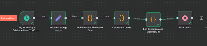

Workflow re-executing with same ID when Wait node over 64 seconds despite QUEUE_WORKER_LOCK_DURATION set to 120s or QUEUE_HEALTH_CHECK_ACTIVE set false
We’re having trouble with a workflow in queue mode that includes a Wait node. Whenever the wait duration is 1 minute 5 seconds or greater, the workflow starts re-executing from the beginning — using the same execution ID. The previous execution continues for a while but stops shortly afterwards. The same thing happens with nodes that process too long, except maybe query nodes.
There are no error messages.
Sorry, I’m not sure I’m allowed to share the details, but it’s reproducible with a scheduled trigger, into an edit fields node, to any code node (to debug execution ID, etc.), and to a wait node with a wait time of 65 seconds or more.

When running we log $execution.id and $workflow.id, these come through the same each time and the workflow re-executes indefinitely, the replaced execution sometimes goes a few nodes onward if there are further nodes connected, but it never gets far and always stops before being able to complete further work which exists for it.

Thanks Erick. Your suggestion to replace it with an external Schedule or a loop with separate nodes reminded me that I hadn’t added a simple 1-second wait into a looping test. We wouldn’t usually need to use a wait node in that 65s+ manner; it was used to reproduce the re-execution easily. But the limitation is reasonable and helpful to understand.
We have an Edit Fields (Set) node with 350 fields (an Oracle requirement) to set. When the number of input items into that large Edit Fields (Set) node reaches a sufficiently high number (9,000 will suffice), the node processing lasts long enough, and it triggers a re-execution. The same thing occurs when it is batched into lots of 3000 using the Loop Over Items node. However, I’ve found the easy solution is to add a 1s wait node in series with the 3k batch being looped into the Edit Fields (Set) node. It’s just a bit ugly and requires testing or knowing which nodes might need this treatment, as well as carefully watching for re-execution during testing. I’m guessing it will be any node that can consume the processor for 65+ seconds, including those where switching immediately re-enters a loop, except those we expect to use concurrency-aware coding, such as ‘await’.
