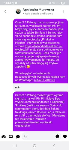

Hello,
My agent sends sometimes double responses and I have no idea on what might be wrong.
I’m sharing my workflow for the review. Please, advise.

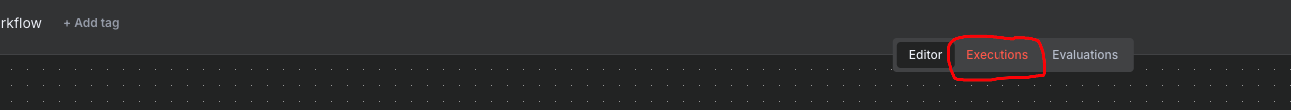

Could you show a screenshot of an execution where you had a double-response?
It should be under Executions:
This will show you a list of executions (hopefully). Find the one which resulted in double response and show a screenshot.

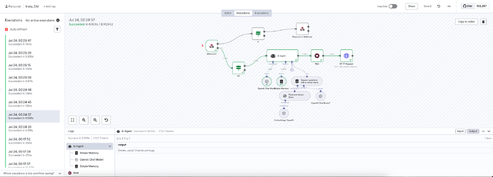

There you go!
Do you see my screenshot?

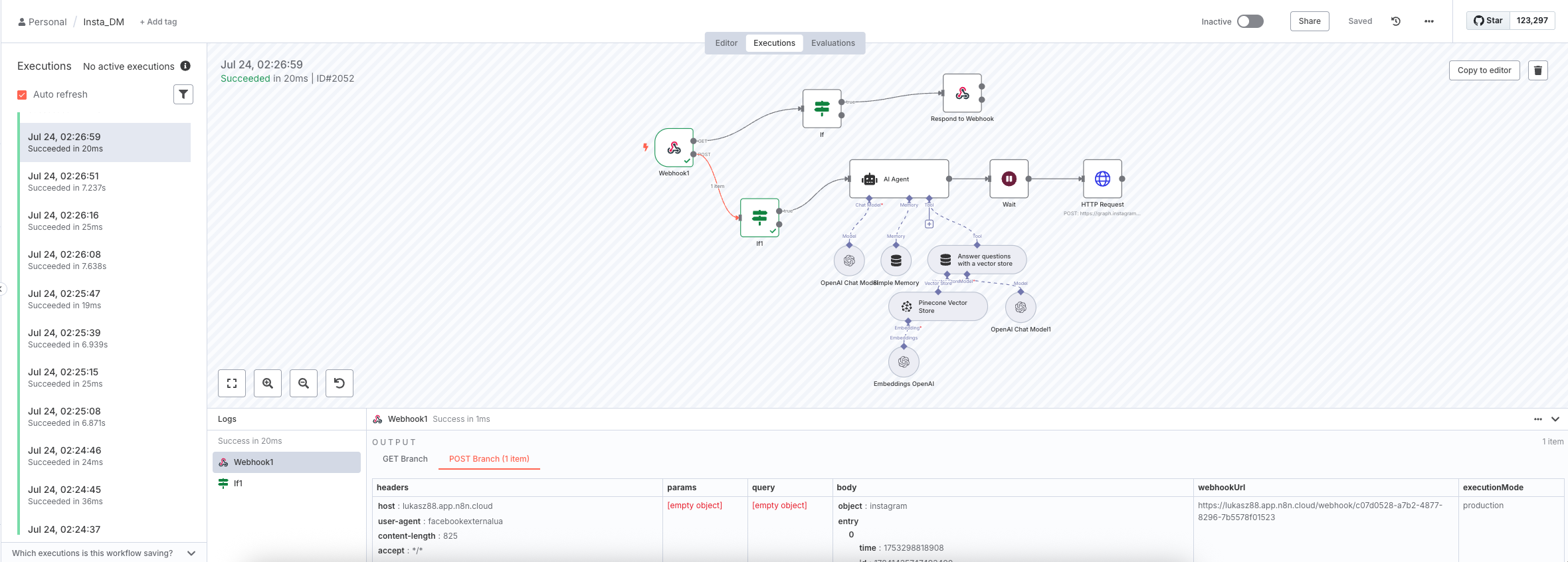

On the screenshot provided I see the workflow wasn’t triggered (likely because the method of the request wasn’t GET.
Oh, pardon me, it was a wrong screenshot. I deleted the correct one and posted the wrong one.
Correct workflow is:

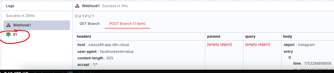

On this screenshot it looks like the execution never passed the “IF” node. Can you click on it in the log:
In this execution, you will see it passes the “if1” node.
I think it doesn’t pass “if1” node just when it wants to repeat itself:

Double response is here. In the previous executions, there are more double responses. Do you want me to show them as well?

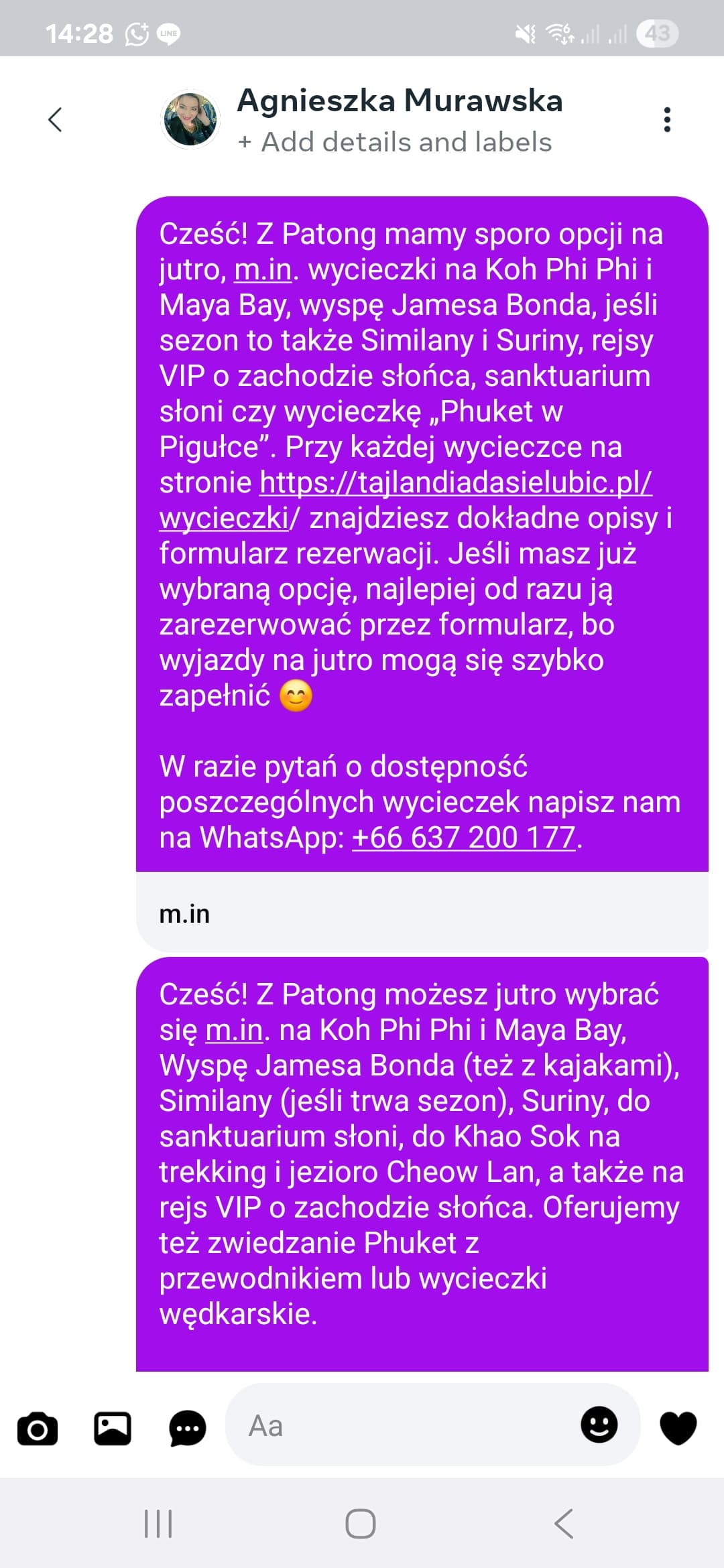

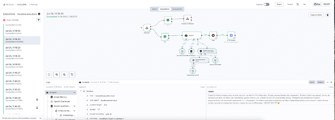

For instance, here there were 3 same responses.
Someone has any idea on why despite setting ‘of’ node, I still more than 1 response to any message?
From the screenshot above we see that each of them have a different webhook trigger (at different times), so if you see two responses, I assume two requests have made it to n8n, which caused n8n to answer twice. Initially I assume I will see a single incoming request and two responses somehow (even though it is not even how requests work), but I see two requests coming in and two requests coming out, which is … normal. So the question is then now why n8n responds twice but why whichever system sends the requests - why does it send two requests, right? Or am I missing something?
Yes, I think something triggers the webhook more than once. The question is: what is it?

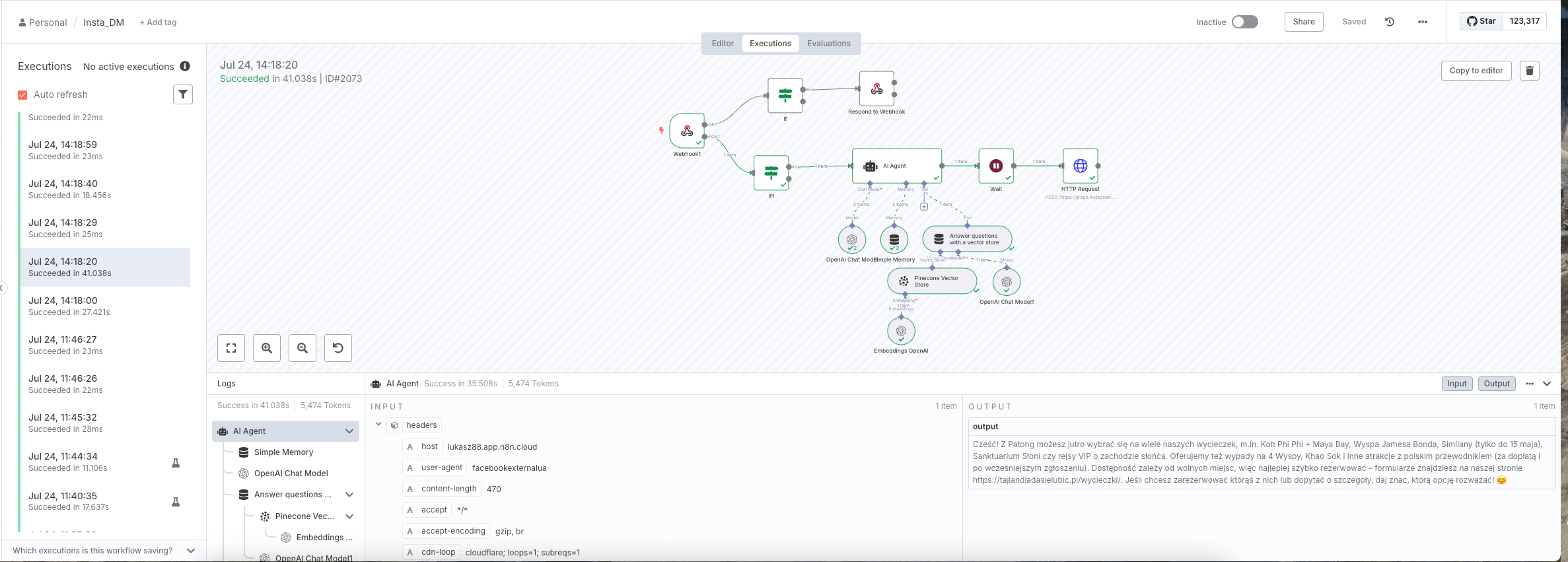

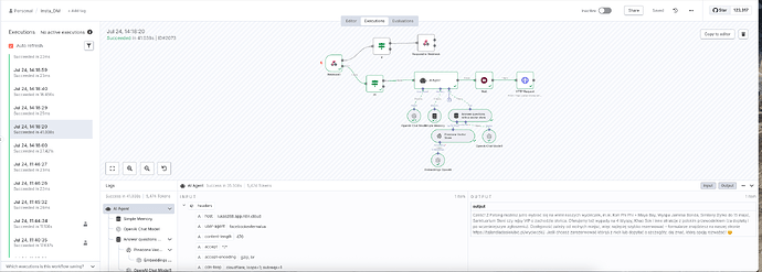

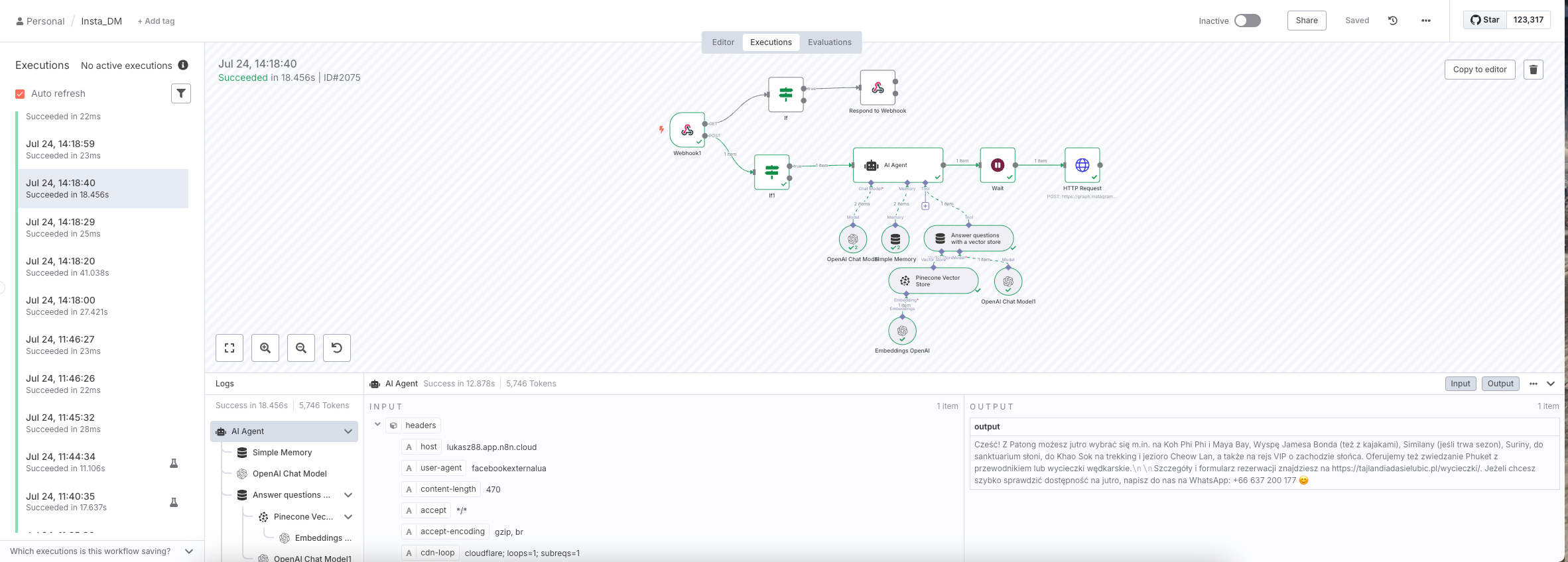

I’m going crazy here around a similar topic, let me share my experience.
Attached 2 images, one with a correct execution, and the other with a faulty execution. Both were execution without changing absolutely nothing, they just happen randomly.
The possibility of execution triggering itself while not impossible (bugs happen) is rather low. Possibility of the server sending another packet to the URL is much higher.
