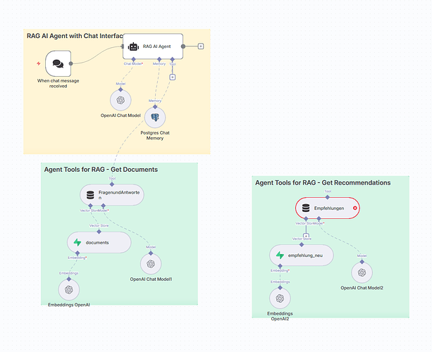

I try to build an ai sales consultant. The setup is attached.
Goal:
  1. User types in chat message
  2. RAG AI Agent finds the right answer to his questions, reply and asks the user if he likes to get a product recommendation (data is stored in supabase vector store; table documents - vector and 1-n chunks per question) –> Already Working
  3. RAG AI Agent finds the right products for recommendation (data is stored in supabase vector store; table recommendations)
    The connection between the two tables is the question_key [frage_key)

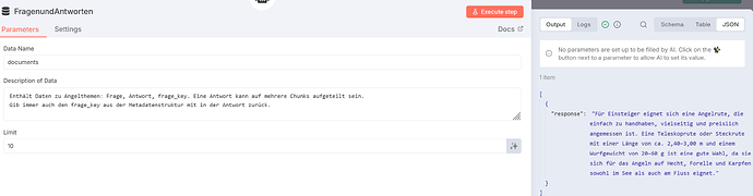

  • The superbase vector store returns the metadata (i need the frage_key, which is the key to find the relevant products (recommendations) in the table recommendations) → the vector store question and answer tool only has the response as an output
  • For the recommendations tool to work properly i need to have the [frage_key]

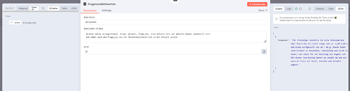

thank you very much for your answer, but i tried and it is not working.
The Vector Store Question and Answer Tool only gives the response, no frage_key is sent to the RAG AI Agent.

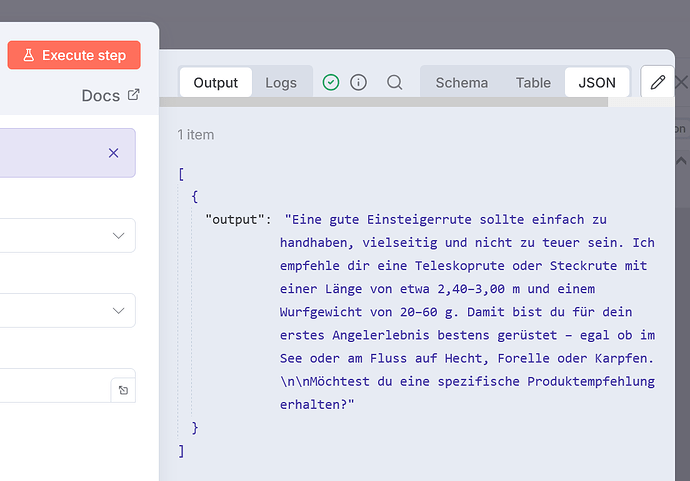

  • Structured Output Parser connected: no result → same error like before
  • Structured Output Parser not connected: answer is right, still only output → it does not contain the frage_key information

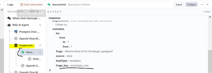

results from supabase vector store:
FragenundAntworten Tool:
