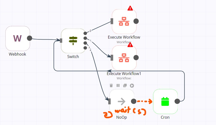

Is it possible to load balance within n8n? Does the following supported:
-global variable, where workflow would set the wf1status=ready/busy value for the switch to know which wf to load balance/call.
-NoOp to support wait by second or Cron to accept input to send request back to Switch if both workflow are busy?
