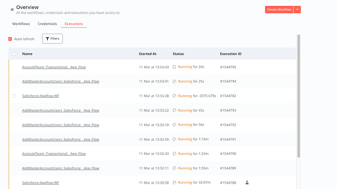

Workflows which triggered by cron node are executing 7 times
Describe the problem/error/question workflows which triggered by cron node are executing 7 times
2 of wf here i canceled manually
  • n8n version: 1.79.3
  • Operating system: linux
i’ve been facing similar issues before where wf triggered by cron node runs more than once with interval of few second in between, unfortunately there was no proper fix.
now it is impacting our production environment.
we are updating the wf based on our needs and saving the new version.
i have noticed my wf is being executed 7 times, and some of them are running old version of wf as well. so within these executions there are updated version of workflow, and old as well. and old version execution owerwrites the new vesrion. so its very critical now.
i have updated the n8n and its running on 1.79.3 at the moment.
i have tried to delete cron node – > save → create node again → save,
but this didnt resolve the issue.
please, advice

i also working on debugging, and i have a thought - so cron triggered wfs are executing 7 times, same count of n8n pods i have in my k8s. i have 7 n8n pods, and 10 worker n8n pods… coincidence?
The forms will typically auto remove any credentials/PIIs.
Actually your point could be valid, if the k8s is not setup right to work as fallback rather then direct replication, are other scenarios being procced multiple times per trigger?
i have 2 workflows which runs daily started by cron node. one of the wokflow has sub-workflows, therefore all of them run multiple times, my count is 7.

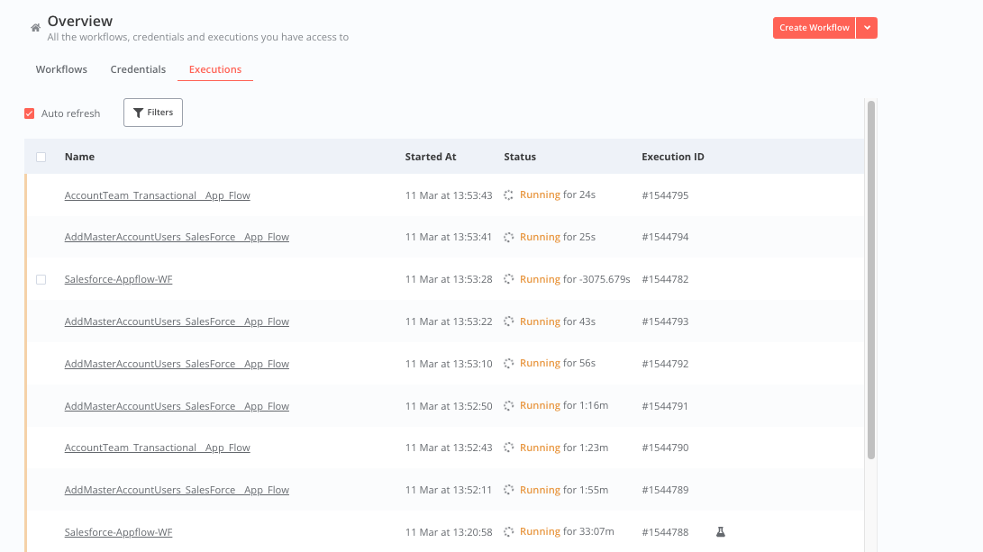

another worrying case is that i ran the workflow manually and saw:
it runs a lot of times even when trigger manually
