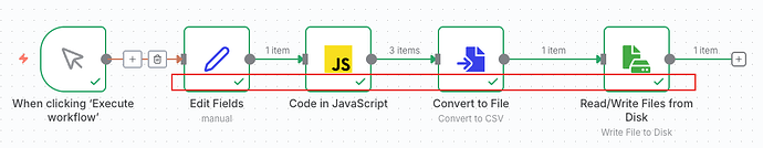

Write Files from Disk failed in n8n2.0 ,but it worked in 1.120.0 version
I try to save some data in local file, it’s a very simple process.
”code in javascript” → convert to file > Read/write file from Disk, and it works in old version like 1.120.0, but when i upgrade to 2.0, when i execute the workflow, it failed, says that the file is not writable.
and this is my config piece of docker-compose.yml
and i have both directories in local environment and docker

Hello @lwwjsdf
In n8n v2, you need to set N8N_RESTRICT_FILE_ACCESS_TO
Make sure to read the breaking change here:
There is also a migration report (Settings > Migration Report) that helps identify what you need to modify for n8n v2..
wow,thanks a lot, i will try
