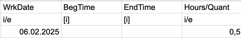

When I open the file in the browser, everyhing is correct. It looks like this (just a small portion of the file):
When I download it right in the browser from the Google Sheets web app as Excel or CSV file everything is fine (except for the wrong delimiter as CSV). The columns are still in the correct order, like on the screenshot.

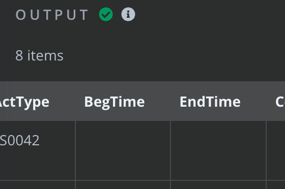

Now back to n8n. I’m using the “Convert to File” node twice here (just for demonstration purposes): one time I export to CSV file (with the correct delimiter), the other time I export to Excel. After the export, but files have messed up the column order. In both versions there comes first all the columns with data in it, then all the empty columns.
It probably depends on the already wrong displayed output of the Google Sheet node, which does the mess up:
As you can see here, the order is not the same is in my first screenshot. But for whatever reason, the Google Sheet itself is looking perfect fine (that was the first screenshot).
But n8n seems to work with the output of the Google Sheet node instead of the real data inside the Google Sheet file.

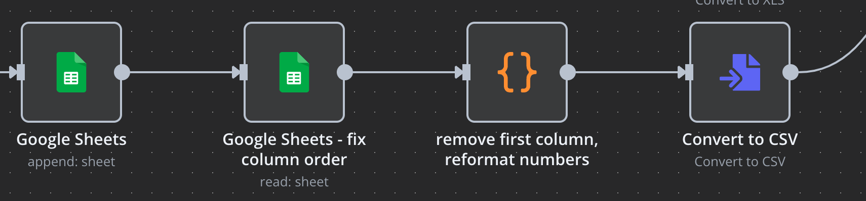

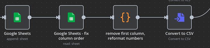

After appending the data to the sheet (where the file itself was fine, but the output data of the node was messed up) I added two new nodes:
  1. a new Google Sheets node to read the newly created sheet with the appended data. This nodes output the data in the correct order, like it is in the file.
  2. an additional code node to remove the added column row_number and also to fix the number formatting. The data in my sheets is formatted for german numbers, e.g. “0,5” instead of “0.5”. For whatever reason the “read: sheet” node just ignores the correct values inside my Google Sheet and just converts it to “0.5”. For whatever reasons.
