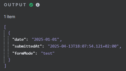

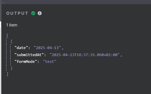

what is the output of the form exactly, can you share it
try this:
Here you see (in Dutch) the form asking for the birth date and date of death. For the first one I filled in 1940 and the second one 2025.
The result for both is that they show as ‘yyy’.
Thanks!
Please just use this node as it is in new workflow and screenshot the output to just know where the issue exists exactly, sounds like the date picker for now…
Yes, this works indeed! Great!

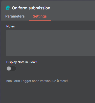

Now check your Form node version
Maybe the issue is there!
Nope, that seems to be the same:

I’m rebuilding it now: I noticed that the output format in my erroneous from different is from the one that you sent (dd/mm/yyyy) vs (yyyy-MM-DD).
I’m not sure yet what the impact of that is, but the form I’m building now seems to have the latter format and that works correctly… No idea how the original form outputs in another format…
