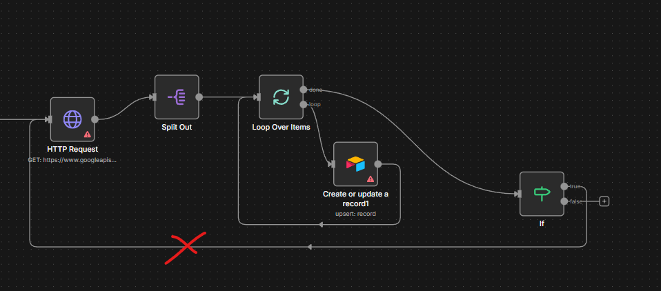

I’m using HTTP request to get video list from my playlist on youtube and save in Airtable. I’ve got problem with handling NextPageToken, to download the next page.
What is the error message ?
The returned response was identical 5x, so requests got stopped
Do you have idea how to fix it?

And why do you have the Loop node?
You are right, loop is not necessary, I’ve modyfied it but the result is the same, error during second execution of http request.
Do not loop the Airtable node back to the HTTP node. Pagination work internally within the first execution.
I’ve deleted loop bout now pagination doesn’t work, only 50 records ale procesed
That means your pagination is set incorrectly and didn’t work before.

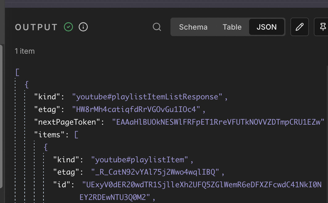

check where the nextPageToken resides in the response. I can’t do it as I don’t have youtube credentials.

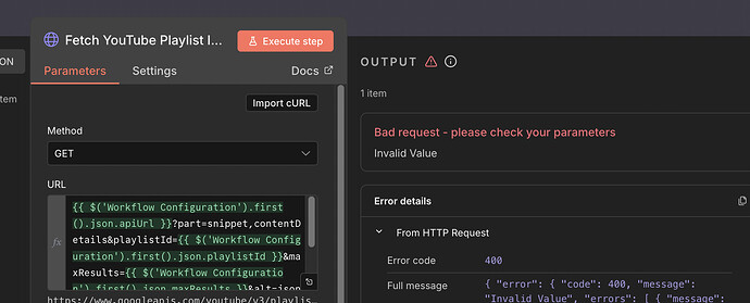

I’ll share what worked for me here. You will have to modify it to meet your needs:
I’ve got an error there:
Request:
“errorMessage”: “Bad request - please check your parameters”,
“errorDescription”: “Invalid Value”,
“errorDetails”: {
“rawErrorMessage”: [
“400 - {"error":{"code":400,"message":"Invalid Value","errors":[{"message":"Invalid Value","domain":"global","reason":"invalid"}]}}”
“httpCode”: “400”
