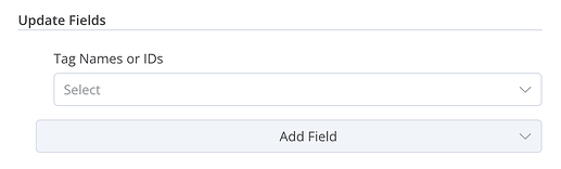

@Angel_Todorov , the node comes with the list of fields that you can update including tags.

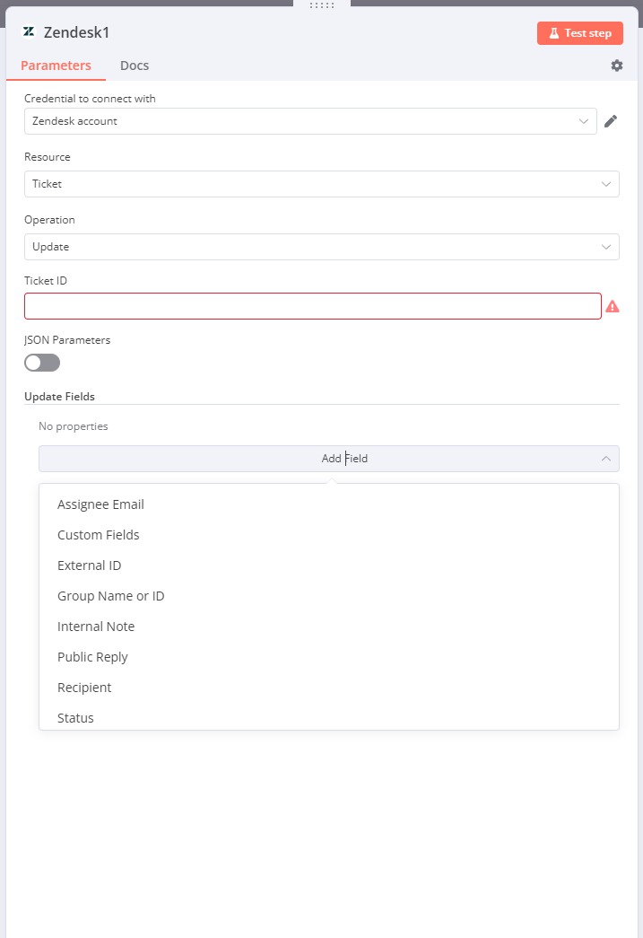

It seems the interface you showed me differs from what I see on my end. I use self hosted version 1.31.2
See it below
If you can help me figure it where exactly I can find Tag Names or IDs that would be great.
Thanks!
@Angel_Todorov , try scrolling down that list or start typing “tag”. There are more items following the last one on your screenshot.
Thanks @ihortom - I didn’t notice additional items, since dropdown is missing the scrollbar. Now I can see them.
