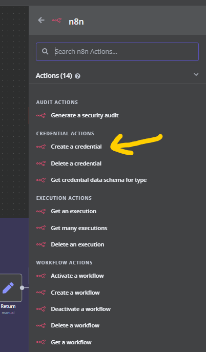

This is the workflow to backup your credentials to GitHub.
To import the credentials you can create a simple workflow and use the N8N node action called “Create credential”
You can pull the files from GitHub and import the credentials. It works pretty well.
