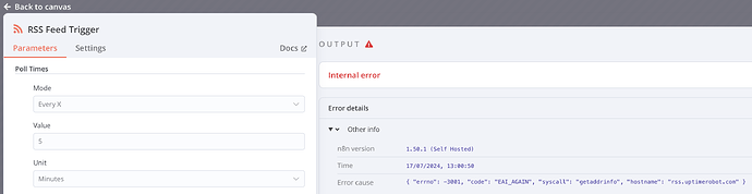

I want to be able to handle errors, if the Rss Trigger node failed to execute. For this I need the node settings to include the “On error” section that most other nodes have.
My use case:
I’m using the self hosted n8n Version 1.47.3

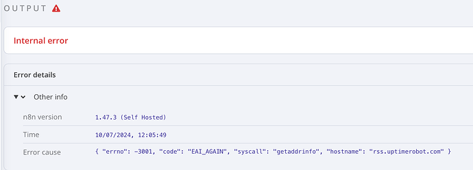

I’m sometimes getting an error from the Rss Trigger node, not often, but it happens, it fails to execute.
