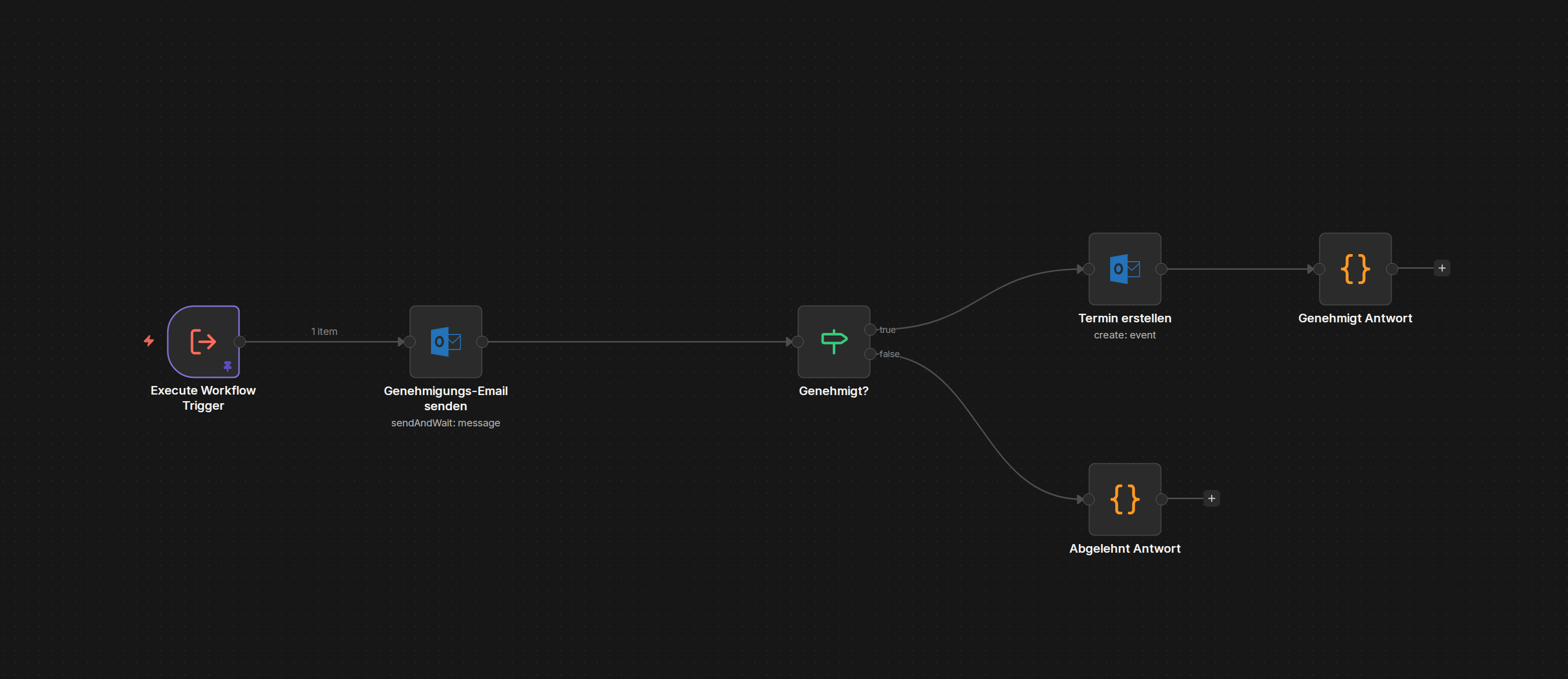

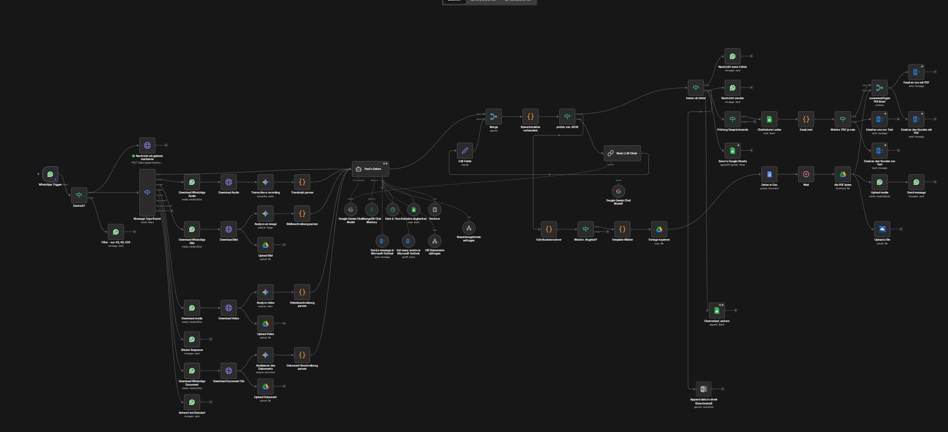

  1. Main Workflow: AI Agent (WhatsApp bot for a roofing company) → Tool: Subworkflow for booking.
  2. Subworkflow: Sends an approval email to me → Wait for Webhook → Books the meeting.

Hi @Tanjuh Welcome to the n8n community!
You can try calling a sub workflow instead of calling an AI Agent as a tool , with sub workflow you not have this problem as AI Agent will wait for the output of the sub workflow before moving forward.
For better understanding, i use a sub workflow tool and this is it. but the problem is that i need the ai agent to generate its answer after the subworkflow is complete
I guess then you are running into a known limitation @Tanjuh, consider keeping the booking/approval wait node in the main workflow instead of inside the sub-workflow that the agent calls. You can also use HITL nodes directly as tools to the AI agent
instead of calling a sub workflow todo that as shown in your workflow, and for best practice consider not using the wait node as a tool for the AI agent.
