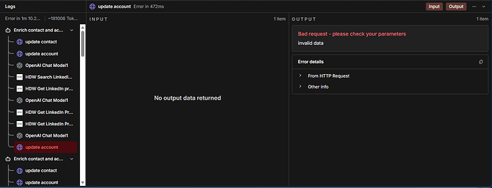

I am finding regularly if an AI Agent gets an error while using a tool, if the problem is with what it is sending to the tool, you never see the input data.
Input data to the tool only seems to show in the log after it runs without an error - which makes troubleshooting very hard!
Or am I looking in the wrong place? I would have thought the log should have as input, then output is the output or the error message.
But you only see Input when the tool call succeeds
Any insights on getting better troubleshooting in these scenarios would be awesome!
If it fails but gets a correct response from the tool, you see the input.
Example: Bad request - please check your parameters invalid data
Your request is invalid or could not be processed by the service
Request failed with status code 412

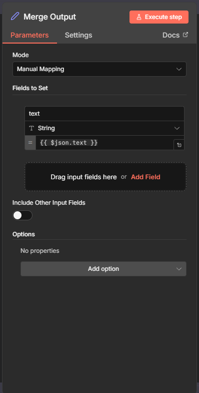

Here is a workflow example of how I use a set node to normalize the input to the AI Agent.
Hope this helps.

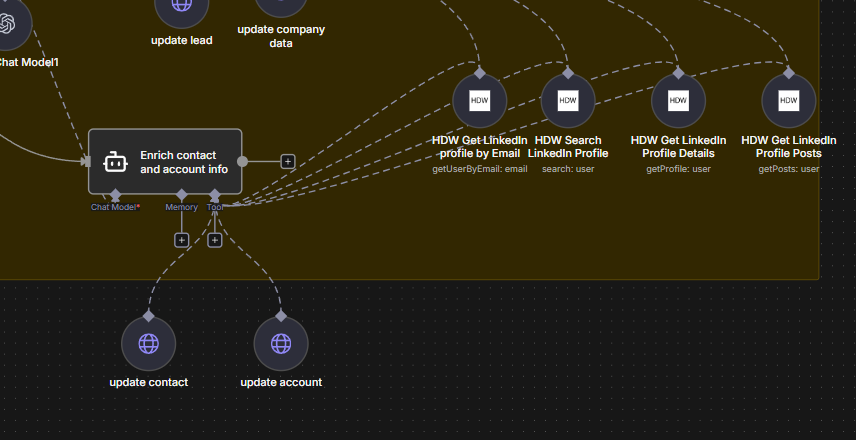

Ahh Thanks, but i dont have any issues sending items tot he AI agent.
The problem is the AI agent sending the FROMAI items to a tool it has access to.
Like this, its when the ai calls a tool and sometimes it will send invalid data to the tool requirements, but cause I cannot see the input, I cannot troubleshoot how to prevent it

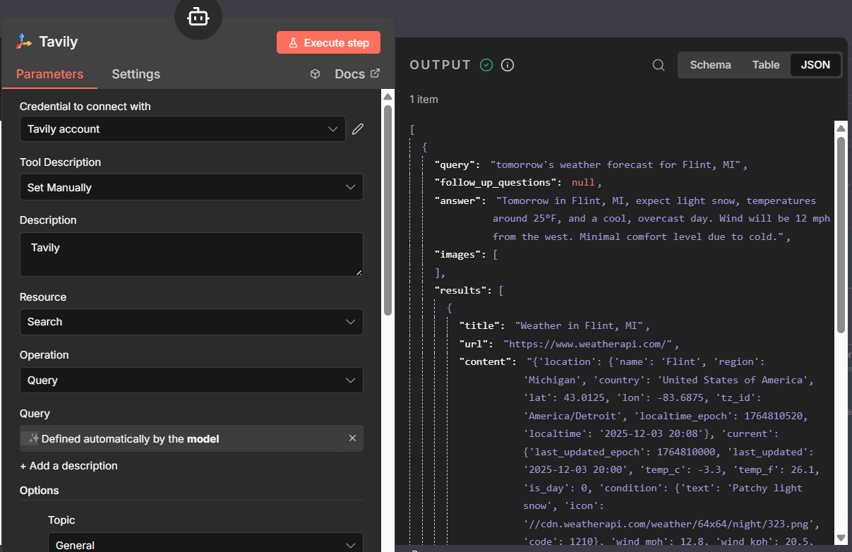

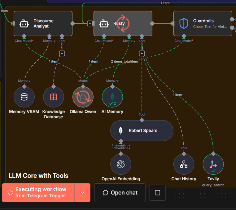

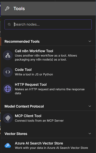

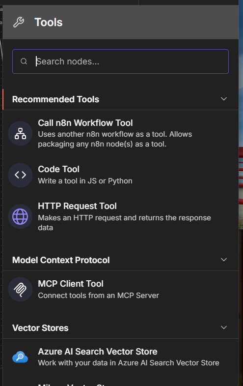

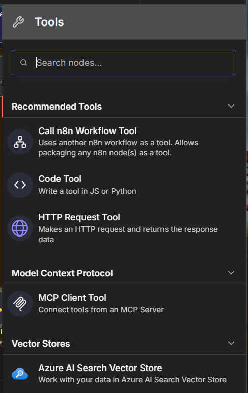

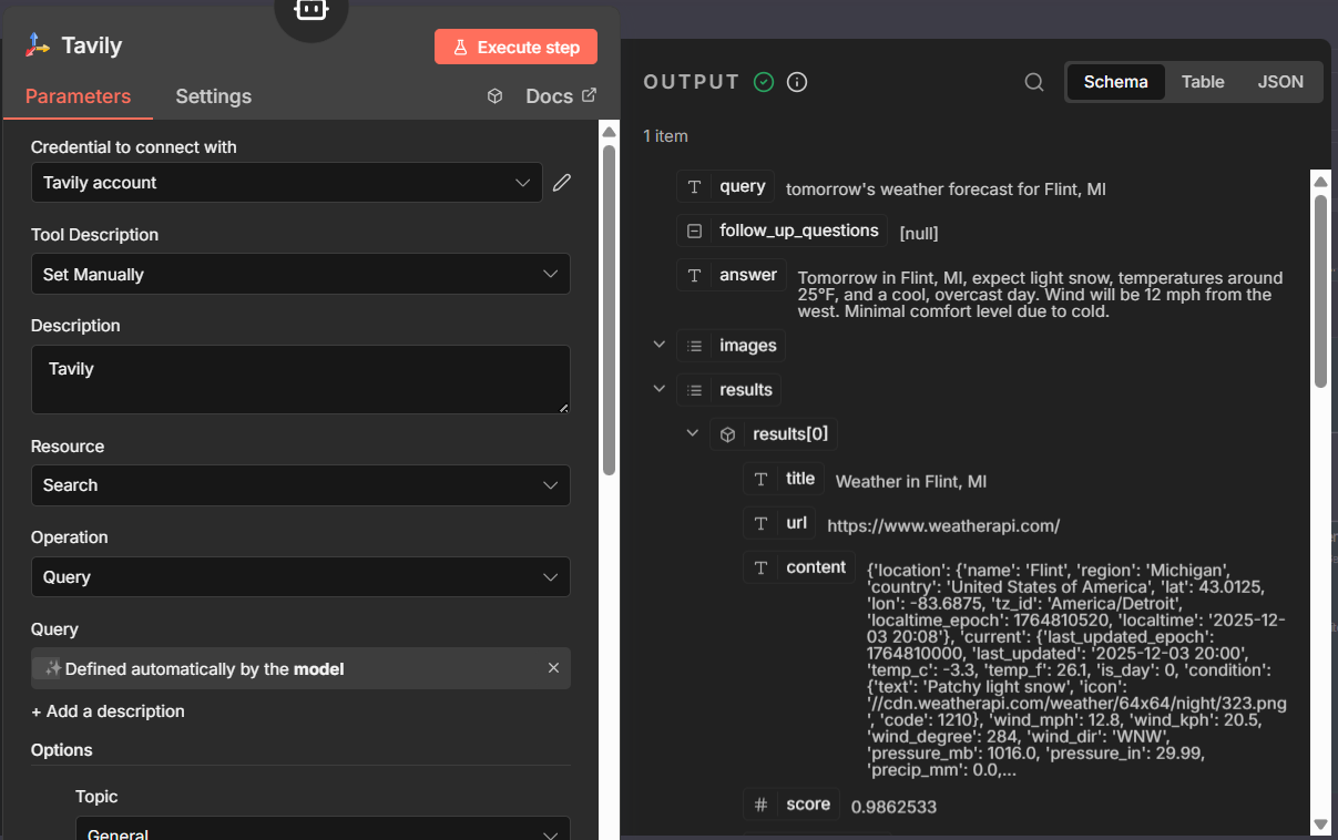

Here’s an example of one of my chat agents, pulled from the same example I used above. In this case, I’m evoking Tavily, for Internet pulls. Here’s what I would do: Set the workflow to inactive, and trigger the workflow, give it an input that would call the tool. In my case, I asked it for tomorrow’s weather forecast. Let the workflow execute. Once it completes, double click the tool node, and look at the log. I’ve included snippets of what I see in Schema and JSON. You can see what query was sent to the tool, usually TEXT, and how it responded. The Logs will also include error messages, if any. If you do not see this, it’s an issue with the tool node, and if it wasn’t written by you (in most cases, not) you will need to reach out to the Dev Team that supports that tool. Remember, all tools are just HTTP Requests with an API call, that’s been wrapped up in a nice package. If you understand the HTTP Request Node, you should be able to write your own tool. Click on Tool in the AI Agent, and you should see the available options shown in my last screen snippet.
Hope this helps, or at least makes sense.

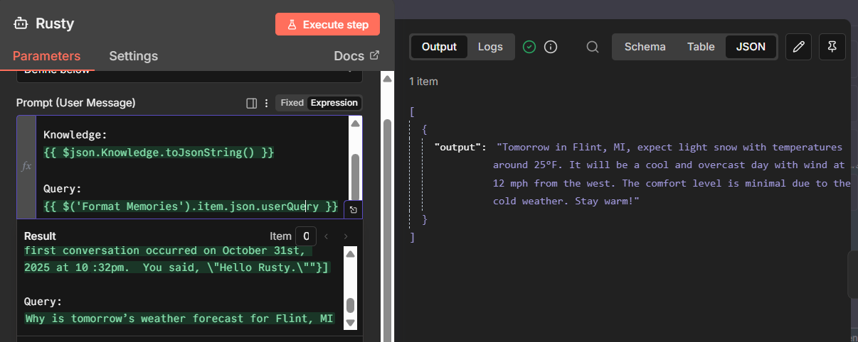

I wanted to include one more snippet. My original request was: “Why [sp] is tomorrow’s weather forecast for Flint, MI”.
Notice that what the AI asked the Tool was: “query”: “tomorrow’s weather forecast for Flint, MI”,
