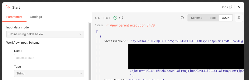

I have a main workflow with an AI Agent node that uses a subworkflow as a tool. I am passing a JWT from the parent workflow to the subworkflow. The JWT is evaluating CORRECTLY when viewing the execution of the parent workflow. When viewing the execution on the subworkflow, that same JWT being passed is malformed/dropping characters/truncating (with ..).

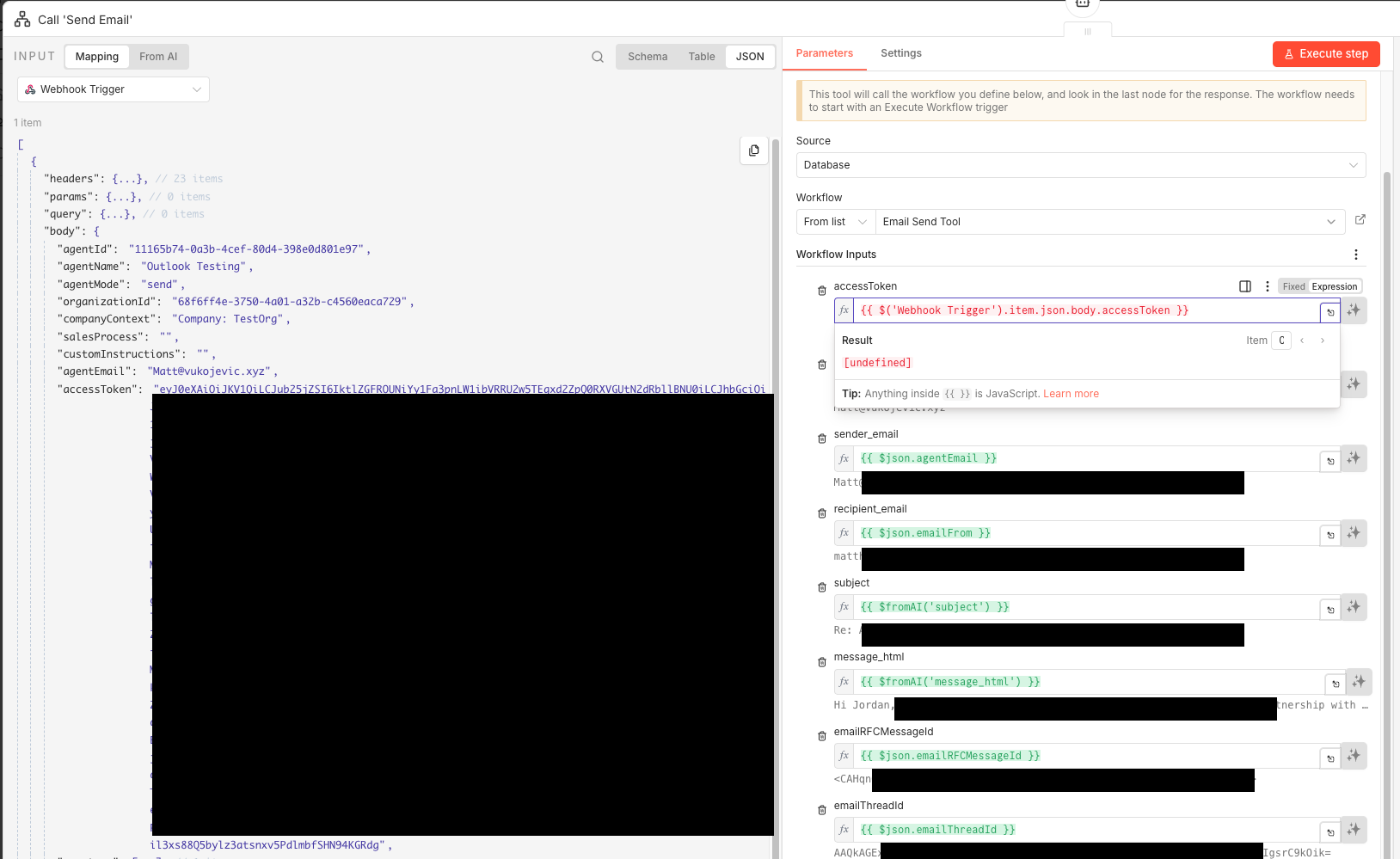

I tried doing the mapping manually to the workflow trigger just by dragging and dropping the field (which should be a string) but kept getting undefined. In screenshot below I have the error execution pinned, and can get it to resolve with {{ $(‘Webhook Trigger’) }} which DOES evaluate to[Object], but anything further than that is undefined (like {{ $(‘Webhook Trigger’).item }}

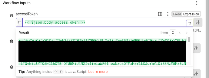

In my previous execution you can see that {{ $json.body.accessToken }}is evaluating correctly to the full JWT (as evidenced by the scroll bar length)
However when looking at the subworkflow execution, you can see it abruptly stops (and the input type on the subworkflow is String

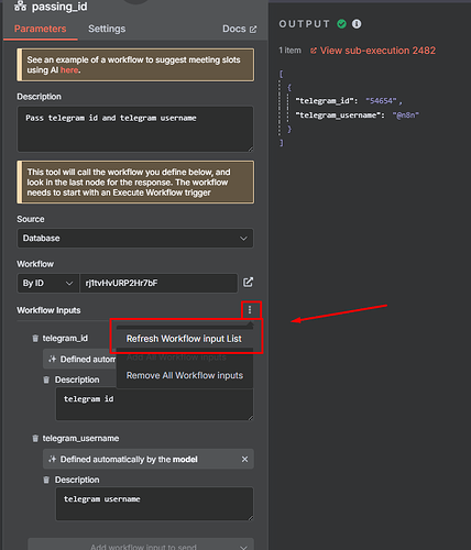

Ok so I don’t know why this worked, but clicking Refresh Workflow input List on the Tool node got it to work.
Screenshot 2026-03-19 at 11.51.41 AM
This came from this other forum topic for a very similar issue: N8N data from main workflow not passing trough in subworkflow
I don’t know WHY this is the case. I’m assuming its just a byproduct of whatever funky stuff n8n + langchain is doing behind the scenes to wire this all up, and comes with the territory of using a workflow tool rather than building a pipeline from scratch.
