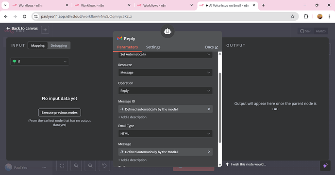

My reply email parameter setting :-

HI @Paul_Yeo
First you will have to create a " Get Email Module" and let main AI Agent take email data from it, then you will have to prompt the AI agent to send the message ID to reply email tool
this worked for me, let me know if you face any issues

I have try your suggestion, I try to drag the massage ID icon to box . Still get the same error.
At telegram it reply below msg to me :-
It seems I can’t find the email thread to reply to. Please provide the message ID or ensure you’re in the correct email conversation.
Below are the video shown how I drag the message ID to reply gmail module :-
Hope that you can advise me again
Paul
Share your workflow once, let me check whats going wrong, also the message ID you have taken, it seems to be telegram message id and not email message id, please check that once

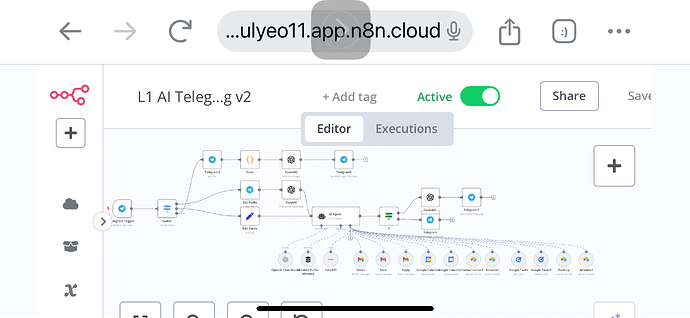

Thank you very much for answer to my post. Below screenshot is my work flow :-
