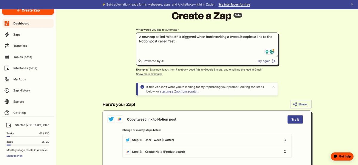

The idea is:
N8n co-pilot to create, debug and suggest best practices to n8n workflows. Make use of the json file to review the workflow and having an engine to run the workflow in a simulated environment.
My use case:
  • Currently using chatgpt to debug my json file when truly stuck but the experience has been sub-par
  • Compete directly with zapier
  • Allow users to be more productive by getting started quickly with projects and faster debugging
  • Allow beginners to be onboarded onto n8n and its many integrations.
  • Increase the number of workflows generated and published on the marketplace for others to utilise
  • Join the ongoing trend of gen ai
Have you used zapier’s text to node feature? How do you find it?
