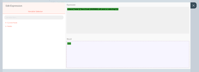

Background/process: (1) n8n checks for ā€˜Last Modified’ on an AirTable table using n8n AirTable Trigger node, (2) it then runs through an n8n IF node to see any of those last modified items in a specific AirTable column has been checked/selected (has a check mark), (3) it then runs through a n8n SET node to set the ā€˜recipient email’, ’ email subject’, and ā€˜email body text’, (4) which then goes to the Send Email node and passes the data from (3)… and is then meant to send the emails, but it only appears to be sending to one user (as opposed to the other six users that I have selected/checked in AirTable to receive an email).

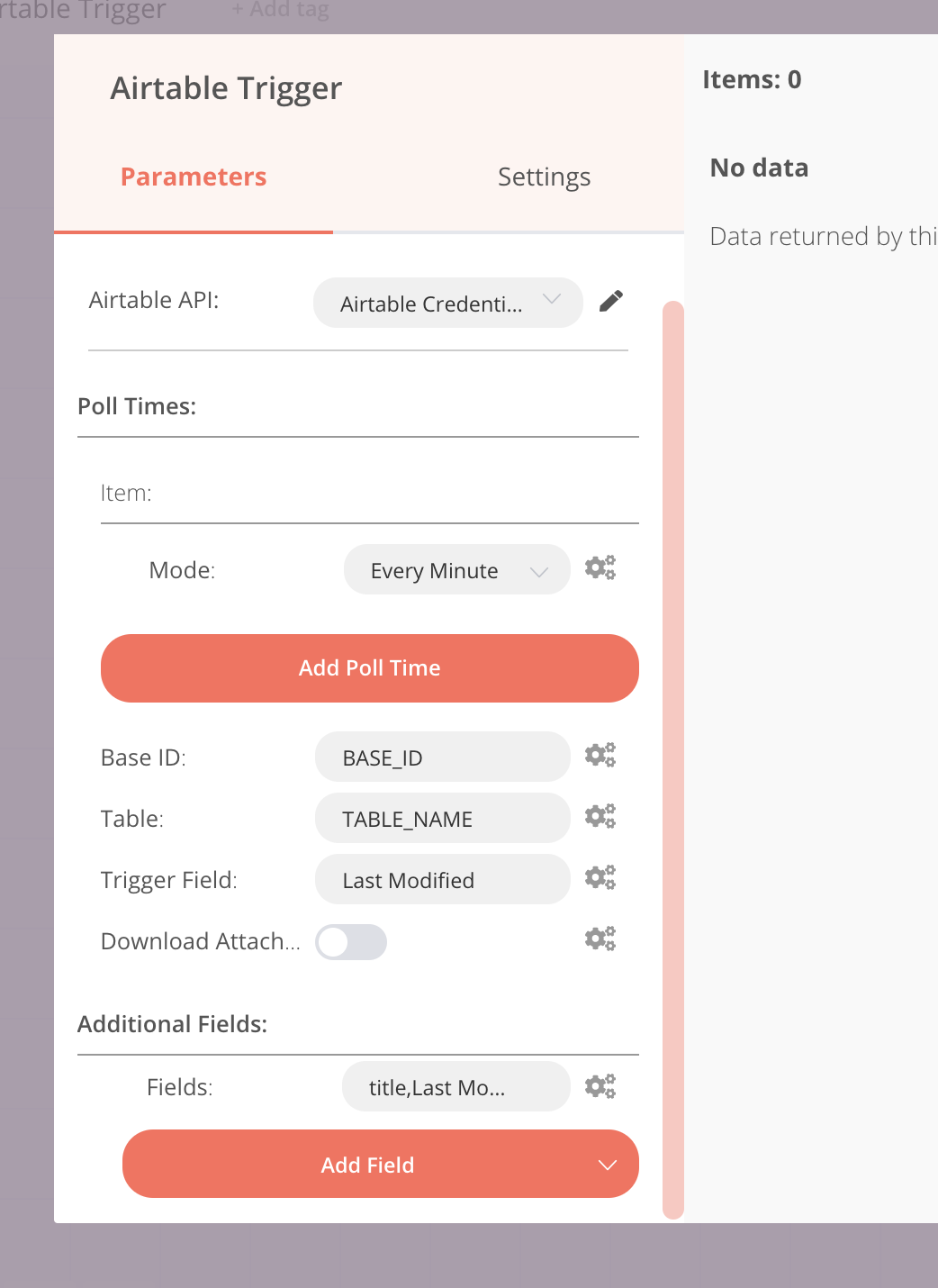

What’s the Poll Time you’ve configured in Airtable Trigger node? Are the modifications made within that time?
When executing the workflow manually, the Airtable Trigger node will return only one result, and hence send out only one email.
When your workflow is active and running automatically, you might receive multiple items from Airtable (provided the modifications were made within that time). For all the records returned by the node, n8n will process each and every record.
Every minute poll time.
All modifications are made within that minute.

Hey @spessex,
I tested with a sample table that contains 324 records. This is what my node looks like:
When executing the node manually, the node returns a random record. In my case which is okay, since I get the fields that I want.
I activated the workflow and tested it thrice. Each time I made changes to a different number of records. The node returned all the records that were modified in that time period (1 minute).
From this test, I am sure that the node is working as expected.
Have you enabled the Execute Once option in the nodes’ setting? If that is enabled, you should disable it. That would be the cause of the issue.
