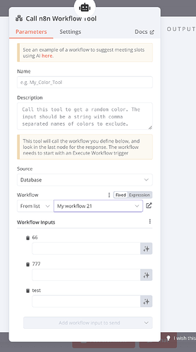

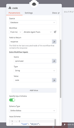

I updated the instance to the latest version and noticed that the workflow tool node for agents has been changed - now you can’t specify input there.
This is really important and here is why:
  1. The same sub-workflow could be used for several tools - it is very convenient not to duplicate dozens of workflows, simplify maintenance and follow the DRY rule.
  2. You can’t specify JSON schema for input - it’s 100% important for developing stable agents. I can specify example JSON in sub-workflow trigger, but it’s not the same as JSON schema. JSON schema allows me to provide details about enum lists, optional variables and so on. It’s the basis for building stable and scalable AI agents.
    In my opinion N8N should not cut basic features that let developers build complex things to replace them with simplified things - we are here and love this tool bcs it is low-code tool that is as simple as no-code tools and powerful as code tools - please don’t make another Zapier from N8N.
  3. Many guides have been created based on previous functionality - new updates generate dozens of QAs and make it impossible to use old guides. It’s a big kick in the teeth for all creators.
As a solution I can offer you to keep both option - let people specify everything on tool side or use definition of sub-workflow if needed.
Here is an example of our approach to building agents - this way I can easily generate new tools with simple prompts to GPT and manage them all within one workflow.
Now we need to create for each Workflow tool own Sub-workflow, specify there not flexible variables (no option for optional params).

Hey @Mark_S,
thanks so much for your feedback and apologies that this change has not met your expectations. I’d love to go over each point from you:

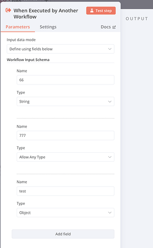

  1. You should still be able to use the same sub-workflow for multiple workflows. Since inputs are generally not mandatory, you could just define more inputs and only use the ones you need in your use case. That being said, we saw with many users that used their AI flows in production, that it was much better to define one tool with its expected inputs for one use case. This way it was easier to understand what the sub-workflow tool is doing and what it expects.
  2. The schema example is taking the JSON schema from the example under the hood. It is true though, that we lose sophisticated things like enums, etc. That is something that we should probably bring back.
  3. Very valid point. We probably underestimated the amount of videos that are out there with the old functionality and I fully understand that this is causing pain. I think it’s one of our strength that n8n moves very quickly. That might mean that some functionality goes stale pretty quickly sometimes unfortunately.
I hope you can understand some of my points. Would love to hear your thoughts on that.
Thanks for the feedback!

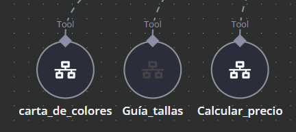

By the way, I see that a new added workflof tool is like “deactivated” while the old ones are active. And this deactivated tool gives the error:
“[ERROR: Received tool input did not match expected schema]”
I assume this is related to this strange updates.

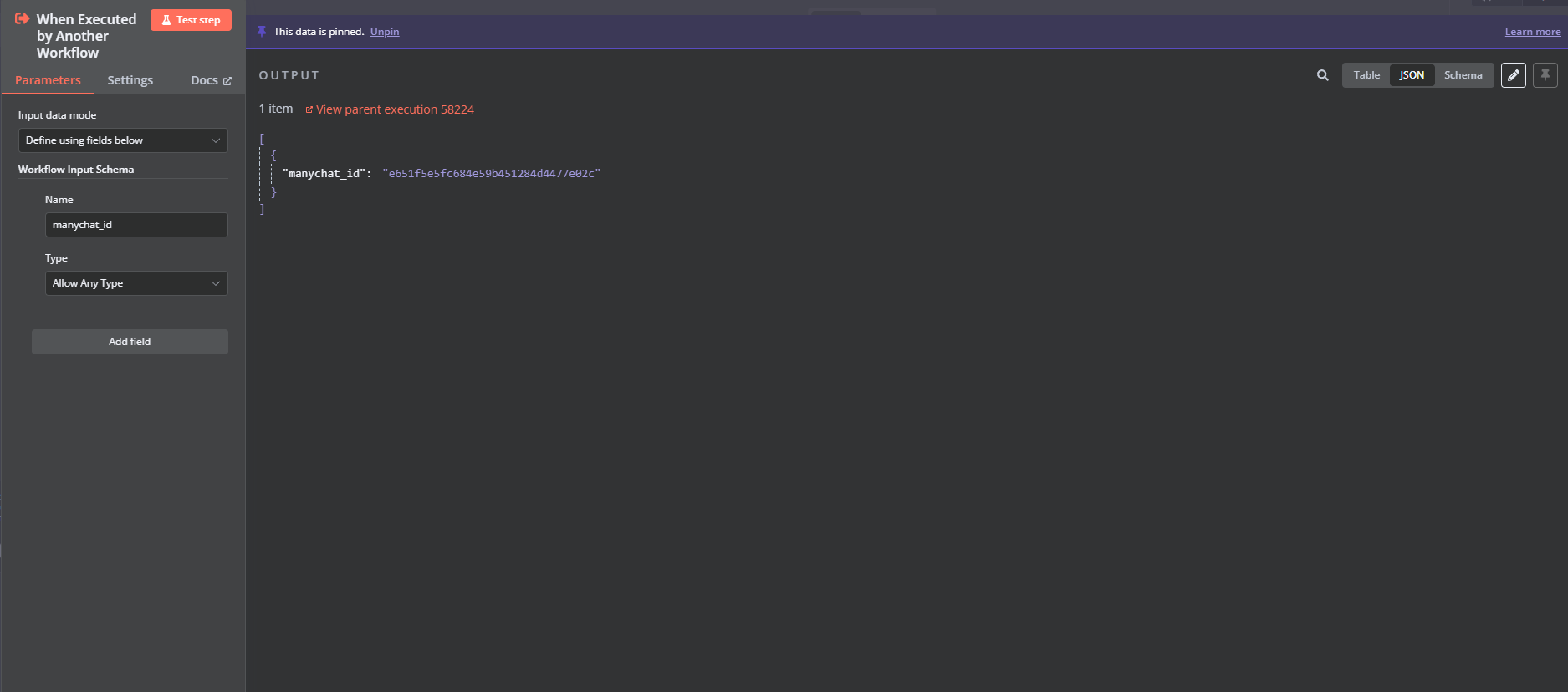

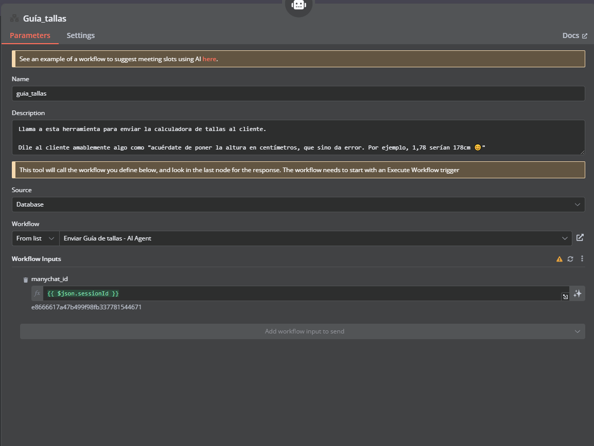

Hey @Disowned-factory, the new tools should not get “deactivated” on their own. Did you maybe disactivate it by mistake? Any chance you could share how your workflow tool that is throwing the error is set up? If you define input fields in your sub-workflow, that error should not be happening.
It is everything well configured but the issue persist…

Hey @Disowned-factory, fully agree that those things should be resolved ASAP. I’m trying to learn a little more about your workflow and sub-workflow right now. Would you mind pasting me both via a DM so that I can try to reproduce some of the things you mentioned? Also, what version are you on?
