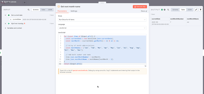

Hi,
All code nodes are affected. They usually have JS, like the one below. Rolled back to version n8n@1.95.2, and now all code nodes steps work again.
for (const item of $input.all()) {
  const currentDate = new Date(item.json.currentDate);
  const nextMonth = (currentDate.getMonth() + 2) % 12 || 12;
  // Array of month abbreviations
  const monthNames = ['Jan', 'Feb', 'Mar', 'Apr', 'May', 'Jun', 'Jul', 'Aug', 'Sep', 'Oct', 'Nov', 'Dec'];
  // Add both number and name
  item.json.nextMonthNumber = nextMonth;
  item.json.nextMonthName = monthNames[nextMonth - 1];
return $input.all();
