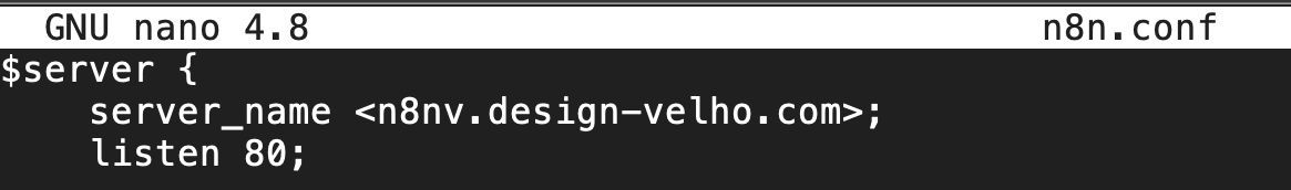

Yes I am. I added the subdomain url to the conf file as the tutorial instructs:
I created the subdomain by using an A record that directs to the server IP. The connection is also secured with the SSL certificate.
Can you share that line of your config file?
Hi Jon,
Here you go
Get @antic1pate,
Remove the < and > then reload nginx and you should be good to go.

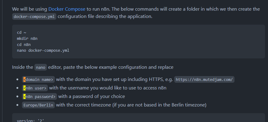

Looks like @Jon already figured it out, I suppose you might also need to request a new certificate using certbot though.
With the < and > I intended to indicate placeholders in the guide. So you’d also need to remove these elsewhere, for example in your docker compose file:
PS: After an internal discussion on a new approach to an officially documented server setup I’ll probably also re-do this guide using the latest Ubuntu LTS version and a simpler web server at some point. Any suggestions on how to better highlight placeholders?

I did think about this for a long while during the installation but somehow I came into the conclusion that I have to leave the those <> characters. Now that I’m looking at it afterwards it looks obvious to me that they should be removed because they are greyed out as well.

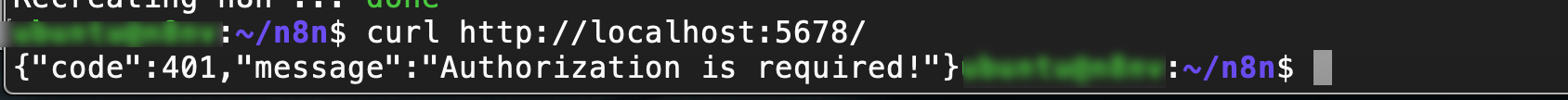

I ran some of the comands from the tutorial to try see what parts are running properly. When installing from the scratch all of these passed but now there seems to be some issues.
Any idea what this conflicting server name is about?
