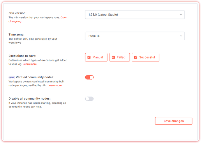

Hi @InfraNodus
The latest stable version of the n8n cloud is 1.93.0
So, you just need to update your n8n cloud.
