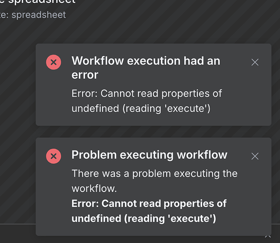

Not sure if this helps better illustrate it but this execution works fine, but as soon as I make the workflow active and it tries to fire from the Schedule trigger it fails with this error shown below.
Let me know if there is any more info that needs to be provided, thanks for the help :slight_smile:
