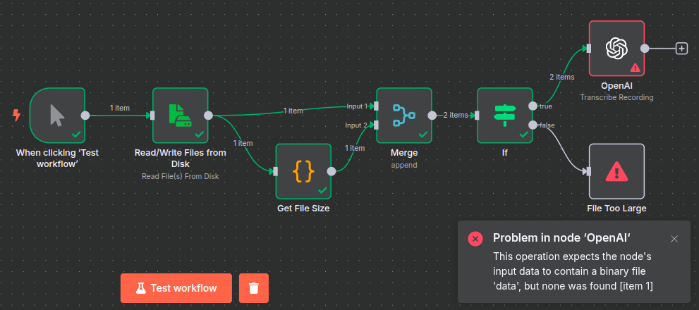

Hey @Jehu . I am also stumped. I must be missing something… If I use merge to bring the binary data and the buffer length and pass it onto the http post request (In my case passing it on to OpenAI node for transcribing), I am struggling to reference the binary data - any ideas? It also doesn’t work if I remove the if statement. but if I pass the Read/Write Files from Disk directly to the OpenAI node, then it works
I use the “Combine” mode in Merge. Then in the next node you have {{ $json.bufferSize }} and the binary data in ‘data’ field.
“Combine” mode did the trick!
“Append” did not work.
Thank you so much @Jehu
