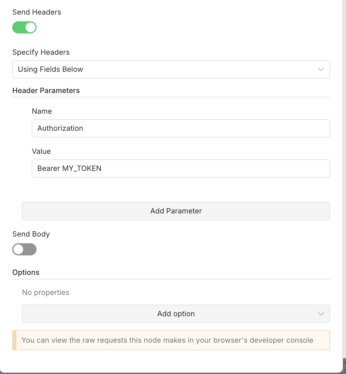

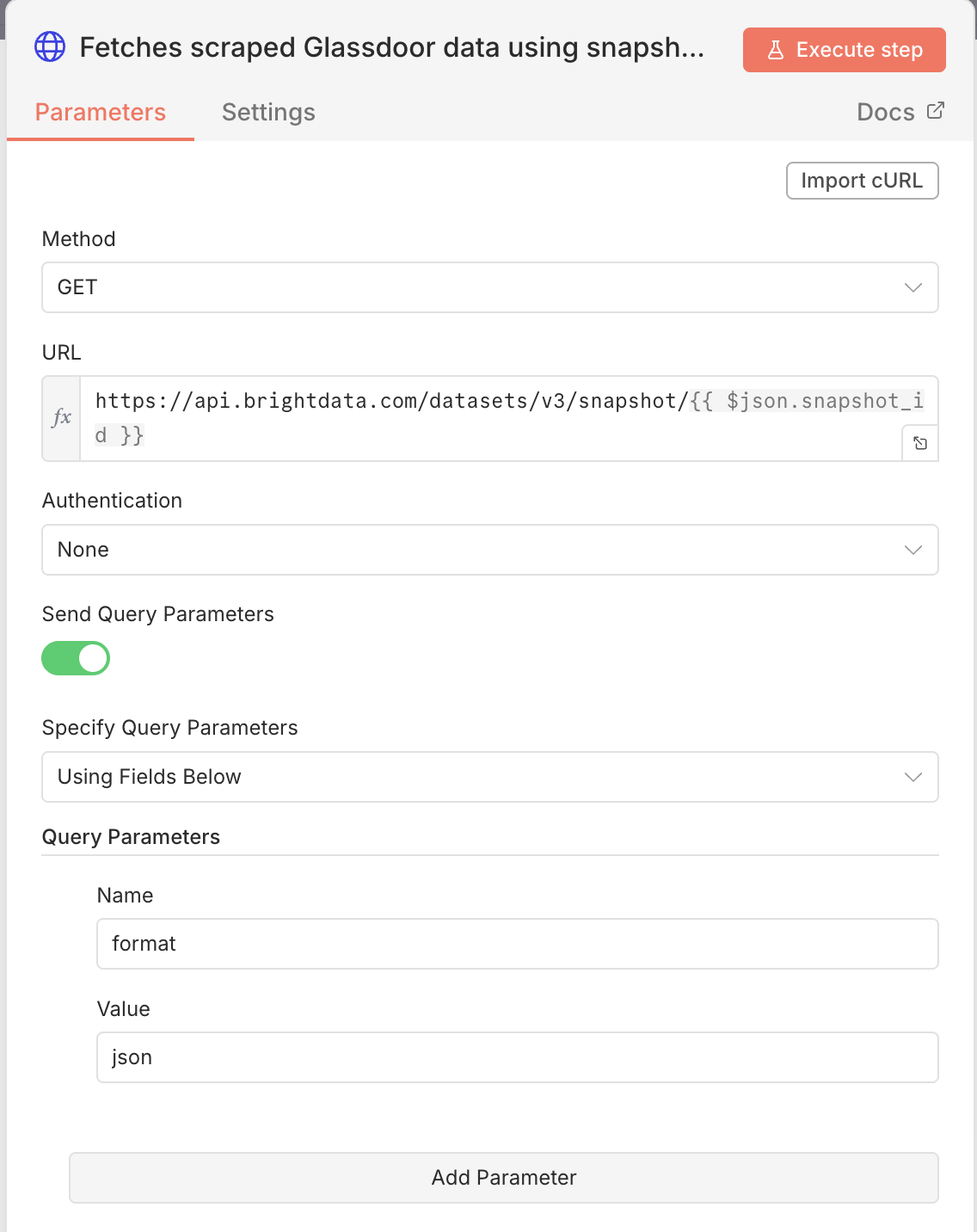

This is how it looks like on Node:
401 - “Token auth is not allowed”
“errorMessage”: “Authorization failed - please check your credentials”,
“errorDescription”: “Token auth is not allowed”,

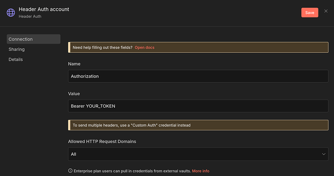

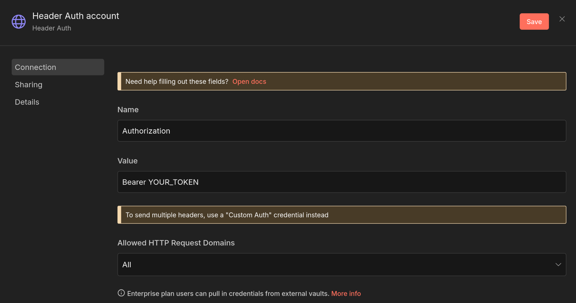

First of all I would recommend to use the built-in credentials feature of n8n. You can add “Header Auth” credentials and add your values as following (YOUR_TOKEN needs to be replaced of course!):
And to fix your issue, I’d recommend to check the current token configuration on Bright Datas side. Can you confirm that the token is valid, has the correct expiration date (e.g. unlimited) and the permission levels align with the scope of your request?

This worked! Thanks a lot
