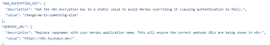

too late to reply but will be useful for other,
You can set it in app.json,
