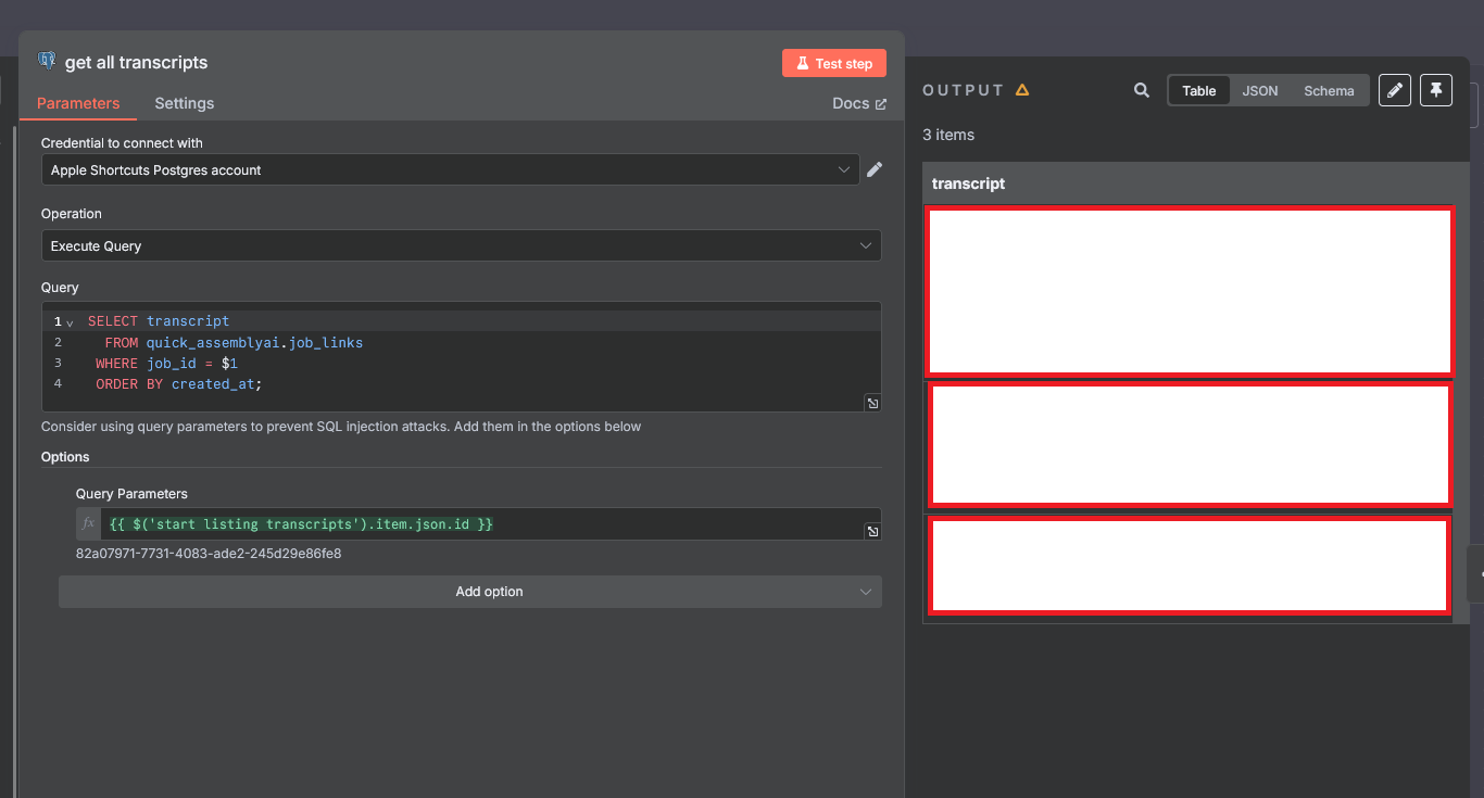

i can’t get the data from the subworkflow nor from the postgres in the same execution
Main workflow:
Helper subworkflow (which I also tried to bundle in the main workflow first but got the same problem)
the subworkflow’s output is consistent with what I expected
but the Execute Workflow node doesn’t output that, with or without the "do nothin"node
i’ve also tried the Postgres node to get the transcripts in the main workflow (you see it deactivated now) but it only brings the output from the database with only one link with transcript, even though the database already have the full transcripts

The TextManipulation node doesnt render. I can’t see what you are trying to reference.
You should be able to fix the psql node, if I can understand your goal more, with an improved query.
Or you could potentially use the n8n fetch execution node after the execute workflow node with the execution ID.
that node isn’t really important to the problem, because the issue is with the sub-workflow node. the point is that i wanted to bring the result of the subworkflow to the main one, which I thought was automatically fetched by the node without any workarounds.

Regarding the problem with Postgres in the main workflow: I think it returns multiple items. You can put an aggregate node after it, so that all items are combined to one list. Maybe this helps
