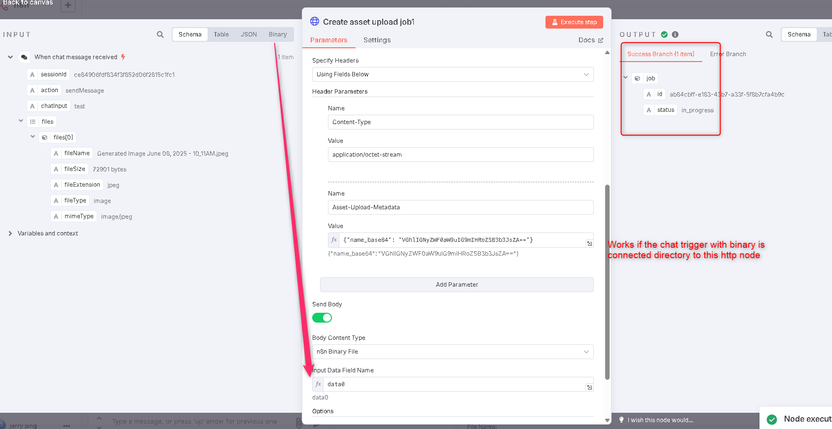

I have the following workflow:
chatinput (with binary) —> a http node (see screenshots and JSON below) , this works and the http node is able to read the binary.
See screenshot:

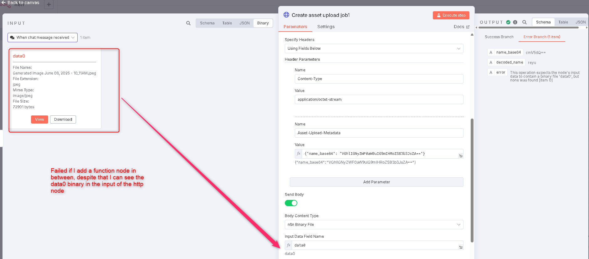

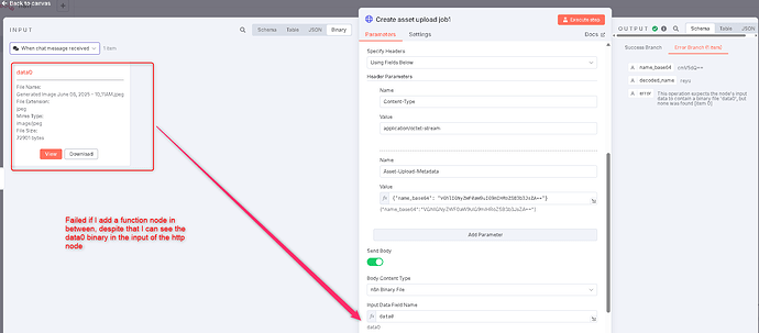

I then added a function node between the chatinput and the http node, and for some reason the http now seem to have trouble reading the binary file despite that the binary is showing in the input, see screenshot,
It’s complaning with error “This operation expects the node’s input data to contain a binary file ‘data0’, but none was found [item 0]”
I can’t figure out why it failed since the binary definitely passed into the http node.
This is the JSON which is Successful

This is the JSON which Failed

Hey @jerry_Cole
Just try one thing I am sharing a node (MAGIC NODE) below, just copy this node and add this in between the code node and http node…and let me know if it works for you or not.
Check this screenshot to see where to place this node
Hello @Sudhanshu_Sharma thanks for that. It worked!
Although I don’t understand why, but thanks heaps!
Hey @jerry_Cole,
Let me explain how it works.
Basically, while working on n8n workflows, it’s kind of difficult to reference binary files from any previous node, just like how we can easily reference the JSON from the previously executed node.
So, what this code does is simply combine two things: the output from the “Convert text to base” node and the binary file from the previous node. so that we can access the both of these things together while make http call.
That’s how it works.
Thanks @Sudhanshu_Sharma . That make sense. :slightly_smiling_face:
