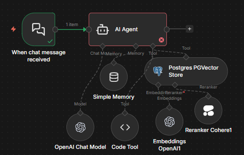

I’m creating a chatbot to use on a website. It used to work correctly, answering questions, etc. But suddenly it stopped working and I get the following message:
Hey, can you share the actual error message text? i cant see the screenshots. Also what n8n version are you on and are you running it via Docker or npm? If you can paste your workflow JSON taht would help a lot too.
Hi @Sofesqivo Welcome! I have personally faced this error and then i have updated my n8n instance and it worked correctly so just upgrade your current n8n instance to the latest stable version.
Expected to find the prompt in an input field called ‘chatInput’ (this is what the chat trigger node node outputs). To use something else, change the ‘Prompt’ parameter
Error details
Other info
Node type
@n8n/n8n-nodes-langchain.agent
Node version
3.1 (Latest)
n8n version
2.10.2 (Self Hosted)
Time
12/3/2026, 8:46:19
Stack trace
NodeOperationError: No prompt specified at getPromptInputByType (/usr/local/lib/node_modules/n8n/node_modules/.pnpm/@n8n+n8n-nodes-langchain@file+packages+@n8n+nodes-langchain_3f8a51621cafcf583d9248e2e2767e62/node_modules/@n8n/n8n-nodes-langchain/utils/helpers.ts:38:10) at prepareItemContext (/usr/local/lib/node_modules/n8n/node_modules/.pnpm/@n8n+n8n-nodes-langchain@file+packages+@n8n+nodes-langchain_3f8a51621cafcf583d9248e2e2767e62/node_modules/@n8n/n8n-nodes-langchain/nodes/agents/Agent/agents/ToolsAgent/V3/helpers/prepareItemContext.ts:47:36) at /usr/local/lib/node_modules/n8n/node_modules/.pnpm/@n8n+n8n-nodes-langchain@file+packages+@n8n+nodes-langchain_3f8a51621cafcf583d9248e2e2767e62/node_modules/@n8n/n8n-nodes-langchain/nodes/agents/Agent/agents/ToolsAgent/V3/helpers/executeBatch.ts:78:47 at Array.map (<anonymous>) at executeBatch (/usr/local/lib/node_modules/n8n/node_modules/.pnpm/@n8n+n8n-nodes-langchain@file+packages+@n8n+nodes-langchain_3f8a51621cafcf583d9248e2e2767e62/node_modules/@n8n/n8n-nodes-langchain/nodes/agents/Agent/agents/ToolsAgent/V3/helpers/executeBatch.ts:73:30) at ExecuteContext.toolsAgentExecute (/usr/local/lib/node_modules/n8n/node_modules/.pnpm/@n8n+n8n-nodes-langchain@file+packages+@n8n+nodes-langchain_3f8a51621cafcf583d9248e2e2767e62/node_modules/@n8n/n8n-nodes-langchain/nodes/agents/Agent/agents/ToolsAgent/V3/execute.ts:46:84) at ExecuteContext.execute (/usr/local/lib/node_modules/n8n/node_modules/.pnpm/@n8n+n8n-nodes-langchain@file+packages+@n8n+nodes-langchain_3f8a51621cafcf583d9248e2e2767e62/node_modules/@n8n/n8n-nodes-langchain/nodes/agents/Agent/V3/AgentV3.node.ts:151:10) at WorkflowExecute.executeNode (/usr/local/lib/node_modules/n8n/node_modules/.pnpm/n8n-core@file+packages+core_@opentelemetry+api@1.9.0_@opentelemetry+exporter-trace-otlp_9f358c3eeaef0d2736f54ac9757ada43/node_modules/n8n-core/src/execution-engine/workflow-execute.ts:1043:8) at WorkflowExecute.runNode (/usr/local/lib/node_modules/n8n/node_modules/.pnpm/n8n-core@file+packages+core_@opentelemetry+api@1.9.0_@opentelemetry+exporter-trace-otlp_9f358c3eeaef0d2736f54ac9757ada43/node_modules/n8n-core/src/execution-engine/workflow-execute.ts:1222:11) at /usr/local/lib/node_modules/n8n/node_modules/.pnpm/n8n-core@file+packages+core_@opentelemetry+api@1.9.0_@opentelemetry+exporter-trace-otlp_9f358c3eeaef0d2736f54ac9757ada43/node_modules/n8n-core/src/execution-engine/workflow-execute.ts:1665:27 at /usr/local/lib/node_modules/n8n/node_modules/.pnpm/n8n-core@file+packages+core_@opentelemetry+api@1.9.0_@opentelemetry+exporter-trace-otlp_9f358c3eeaef0d2736f54ac9757ada43/node_modules/n8n-core/src/execution-engine/workflow-execute.ts:2308:11
Thanks to checking the PostgreSQL settings as you suggested, I noticed an error in the n8n container; it was due to a missing section when creating it. Thank you very much!
