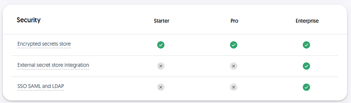

I don’t think the self-hosted community edition of n8n is really intended for “shared environments”
So If we are referring to an Enterprise setup, it indeed includes stricter security
External secret store integration
Fetch secrets from an external source without ever saving them in n8n. We support AWS Secrets Manager, Infisical and HashiCorp Vault.
I think I’ve found the answer to my curiosity! :smiley:
