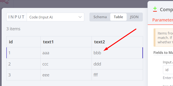

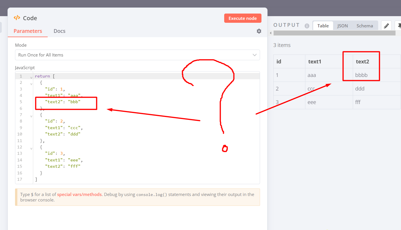

  4. Take a look at the Input A to the left. Now the text2 property is equal to “bbbb”, but it is actually “bbb”
before:
after:

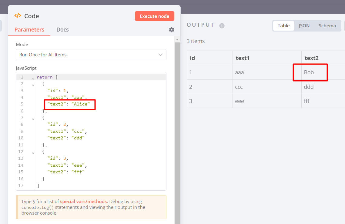

@Jon Did you try just launch the workflow I provided without extra nodes? You should see the Code node output is changed by this later node. How is that possible?
Re-running the Code node helps
