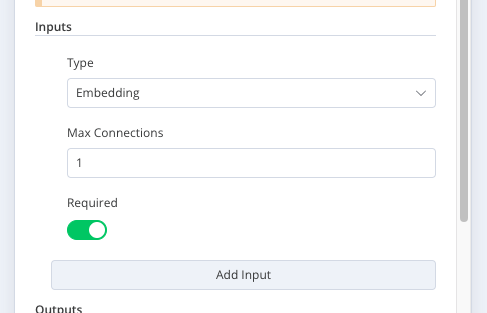

Hey @Markus_Walther
You need to set your input to max connections to 1 otherwise this.getInputConnectionData('ai_embedding', 0) returns an array.
Alternatively, if you need to use more than 1 embedding model
const [
  embeddingModel1,
  embeddingModel2
] = await this.getInputConnectionData('ai_embedding', 0)
Hey @Jim_Le ,
that was it. That fixed the problem.
Thank you very much!
