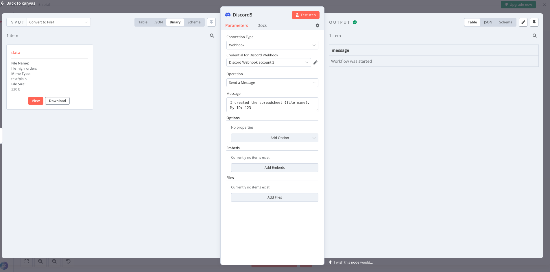

The discord node in level 2 is not working it only says message started but never gets send.

yeah i have seen the discord channel and i can’t see my message there. The node is working for the level 1 course the output comes to message sent but not for the course level 2.
That looks like it is running as we would expect, But there has been some incorrect data posted recently to the endpoint.
Yeah because i was trying from the other discord node and by mistake i didn’t change the credentials so the dat from the course level 1 got sent. When will I be able to see my message in the discord channel?
Hey @Sunil_Choudhary,
If you send the correct data you will see the message in the channel, Maybe we need to update the workflow to make it clearer that there is an error.

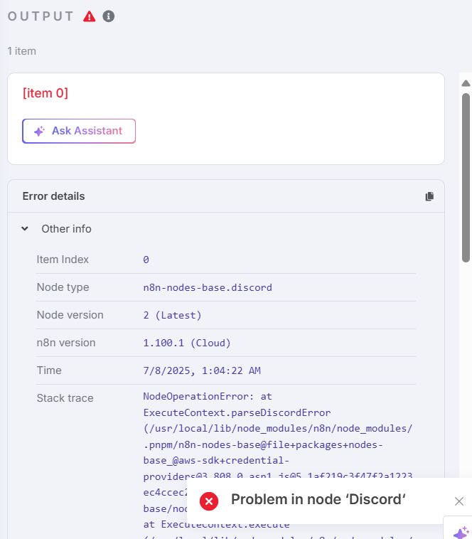

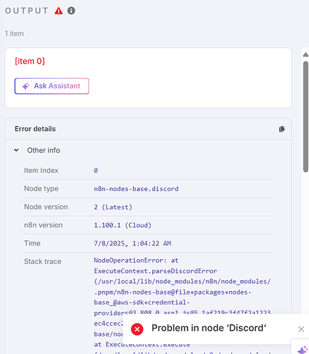

Hi there,
I am getting the following error when I try to send a message to discord using the webhook URL that i received for Leve 2 course. I tried with simple text and no expressions, still the same error. Pls help as this seems to be one of the requirements to get the badge.

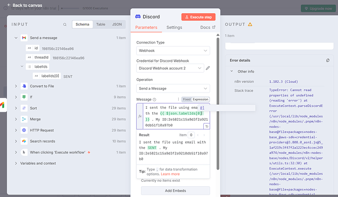

I also had an issue with the Discord node.
I tried lots of things and even considered downgrading my version, but ultimately, I think the N8N team has strict rules for validating the messages we send.
For me it was the space between “ID” and my ID.
You have the same mistake in your screen @amenn_killer
From what I have worked with htis workflow, the discord node message should be exactly same format as the sample text mentioned (including spaces and number of words). Only then the message is accepted by discord server of n8n sucessfully
