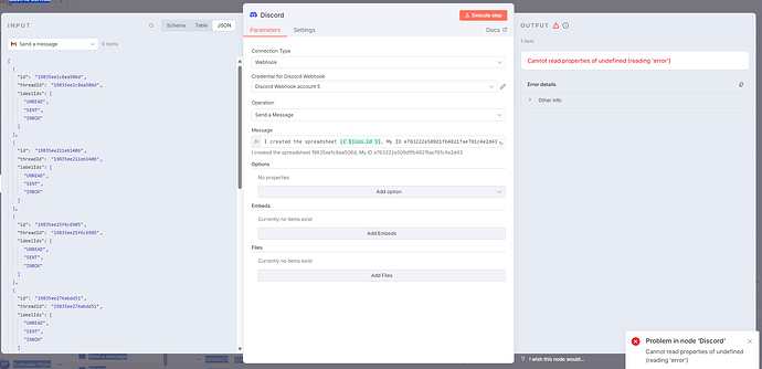

Yes, please find a screenshot, jfyi the error today is different, I am not seeing the incorrectly formated messages but “cannot read properties” errors on my flow and on the solution flow with which I tested.I am attaching a screenshot from the “solution” flow:

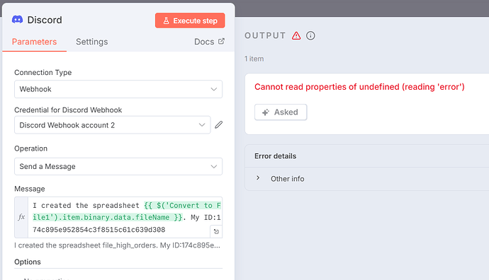

I appreciate you are trying to help but its not that, that was already tried with fixed and expression syntax before opening the forum topic and its already mentioned in the description, for your reference attaching screenshot.
Also worth to mention that the error now is different compared to the last 2 days. It changed from “incorrect message format” to “Cannot read properties of undefined data”. What I lastly tried was to create a new webhook with a wrong Discord URL, upon testing , the correct webhook and the wrong webhook, they both give the same error. I am suspecting there could be an issue with the discord URL i was provided upon registering to level 2 course.|

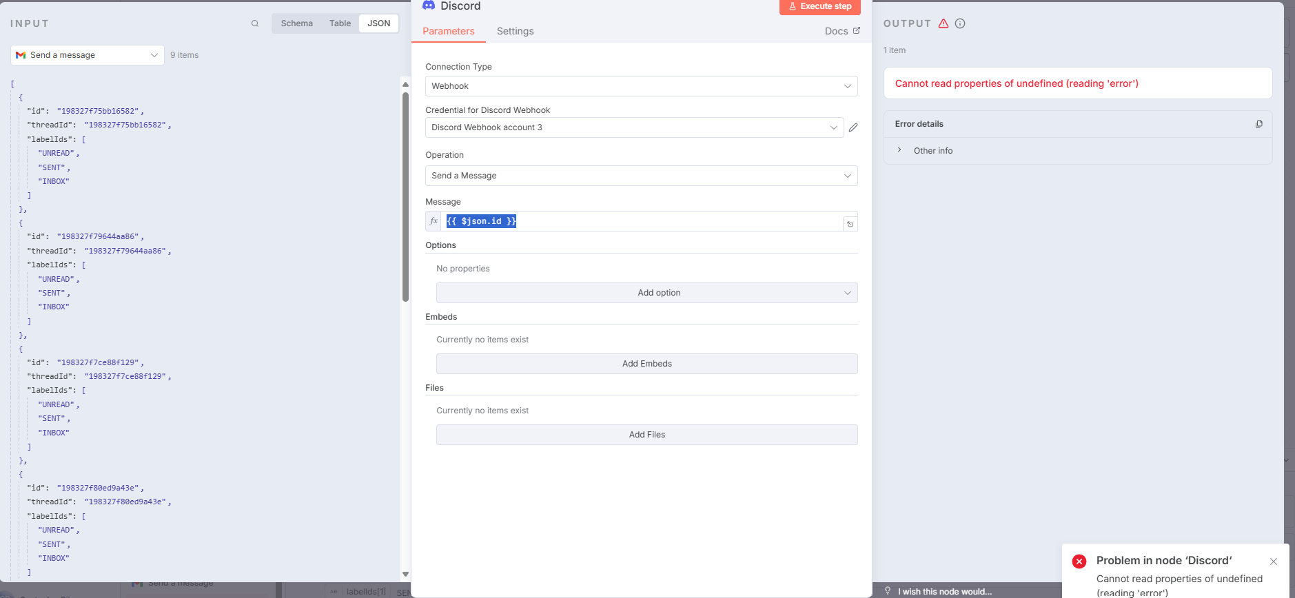

Didn’t know that course level 1 and level 2 need different registrations, so I also registered for level 2. With the Discord URL from the registration email for level 2 I also get:
