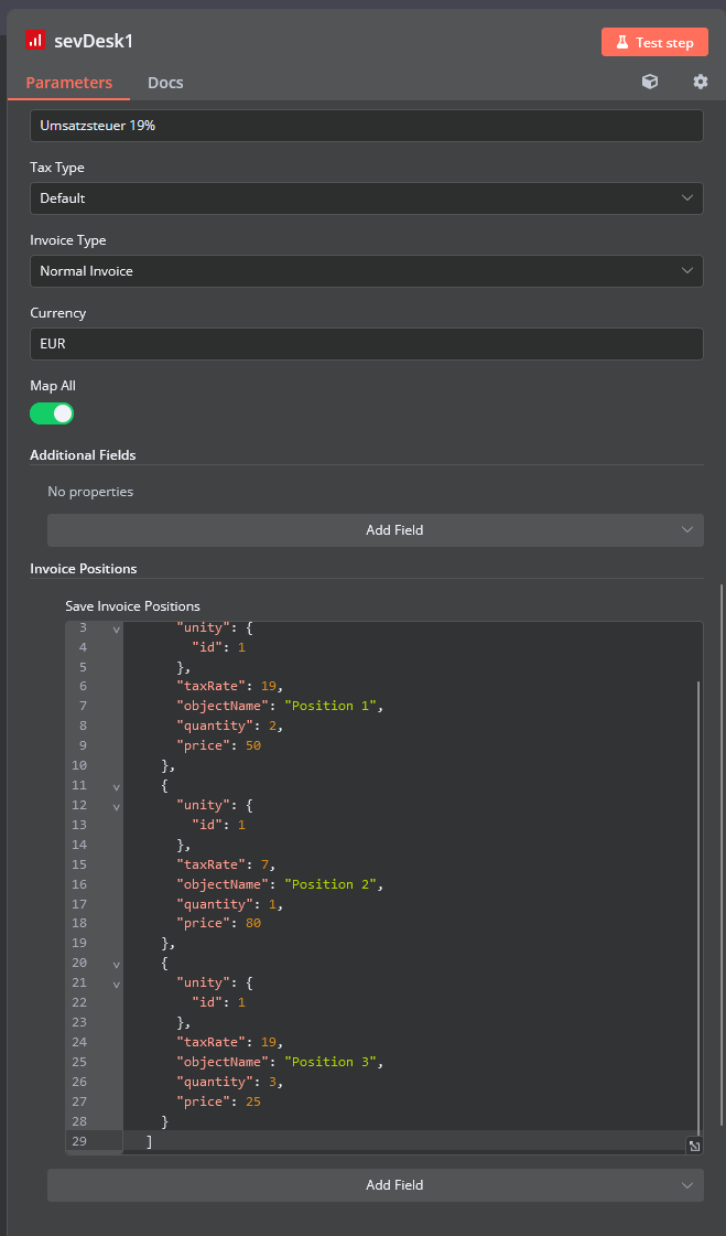

When I use this in “Save Invoice Positions”:
      "unity": {
        "id": 1
      "taxRate": 19,
      "objectName": "Position 1",
      "quantity": 2,
      "price": 50
      "unity": {
        "id": 1
      "taxRate": 7,
      "objectName": "Position 2",
      "quantity": 1,
      "price": 80
      "unity": {
        "id": 1
      "taxRate": 19,
      "objectName": "Position 3",
      "quantity": 3,
      "price": 25
I get
Error code
400
Full message
Request failed with status code 400
Error data
{ "objects": null, "error": { "message": "invoice expected array with 'id' and 'objectName'. array given", "code": null, "data": null, "exceptionUUID": "removed" } }
Here is a screenshot of the node:

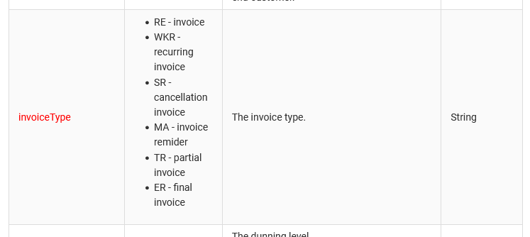

the invoice type is defined here:
https://api.sevdesk.de/#tag/Invoice/Attributes-of-an-invoice
