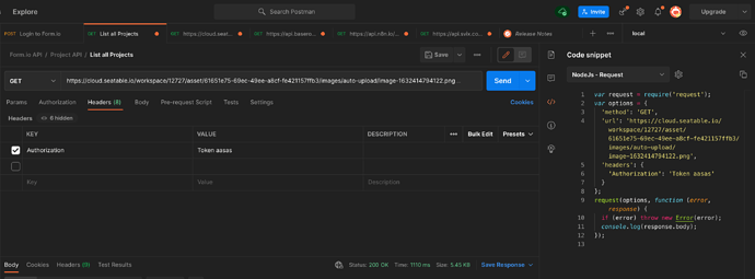

Sometimes when I cannot figure what the curl command at hand is doing, I would go to Postman, paste the curl request, and finally get the code snippet using the request library (check the image below). It is much easier to set up the n8n HTTP node since its design is based on the request library. I hope that makes sense.
